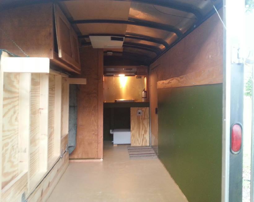

struggling with the pics but if this works this is were I am at now. I will figure it out and post more with a few questions. 3 months into this with what seems like hundreds of hours. I didn't know weather to use the BUILD JOURNEL forum or this one but maybe the moderators will correct me.141490

Hey Dave. I did figure out the resize issue and will post many helpful pictures. I have to do it from home though. Should be tonight. My rig has a stove, sink, toilet, AC, Heat, and a 20 gallon fresh water tank. I still need to install the toilet,vent pipe, black tank and valves. That is my last BIG hurtle. The bed folds up and I can put my atv or dirt bike in there easy. Just ordered a new door from Hallmark that has a slider window too.

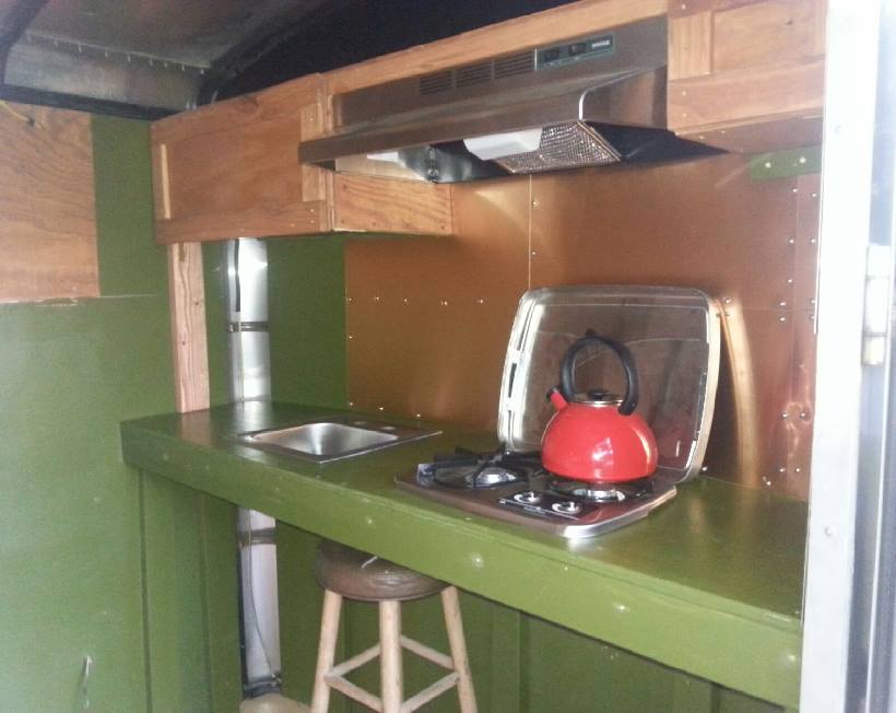

Kitchen and bath

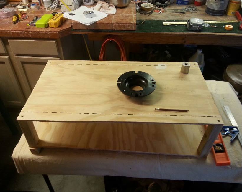

This is the mock black tank I made to spec. I need to figure out a way to temporarily mount it and then mark my 3 inch and 1-1/2 inch hole sites and also mark the ceiling hole spot. Then I will order the tank with the custom fittings done at the factory. I don't know yet if I will strap it or weld it in. The tank is 15 Gallons. I have some reservations here but I will proceed SLOWLY.

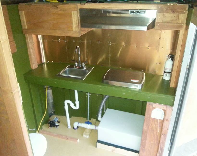

one more

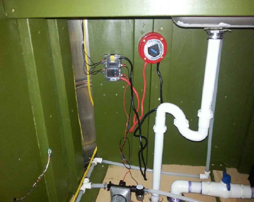

DC Buss set up. Sorry it blurry

Postby Tommy B » Wed May 11, 2016 2:39 pm
One BIG mistake this simple man made was to hook up that perko battery switch wrong. Placed the pos and neg terminals inside the switch. After hooking up the terminal posts outside on the battery ( with the switch on and wired wrong ) I went around to see my new dc lighting work but instead saw the switch giving off white smoke like a fire extinguisher. By The time I was able to remove the post terminal the switch had melted along with the attaching terminal. Almost burnt my trailer up right there. Yeah...

Postby hankaye » Wed May 11, 2016 4:13 pm
Tommy B, Howdy;
The outlet pipe for your Black tank might probably be a 3" as that is the size used for RVs.
Thought I might mention it before you get to far along. What you have accomplished so far
is outstanding, by-the-way.

Postby lrrowe » Wed May 11, 2016 5:47 pm
Tommy B wrote:One BIG mistake this simple man made was to hook up that perko battery switch wrong. Placed the pos and neg terminals inside the switch. After hooking up the terminal posts outside on the battery ( with the switch on and wired wrong ) I went around to see my new dc lighting work but instead saw the switch giving off white smoke like a fire extinguisher. By The time I was able to remove the post terminal the switch had melted along with the attaching terminal. Almost burnt my trailer up right there. Yeah...
We all make bad (notice I did not say stupid) acts. The other day I laid my aluminum ladder against my bench and it made contact with both terminals of my 12 V Sea Doo battery. By the time I smelled the melt down it was too late. Both terminals were melted and the case started to go.
BTW, do not worry about what others might think of your work. You only have to be safe and please yourself.
