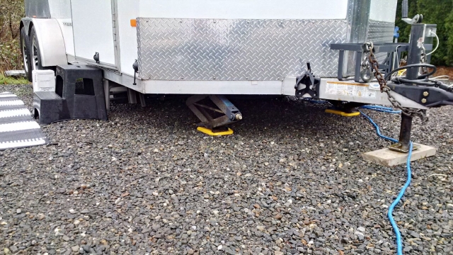

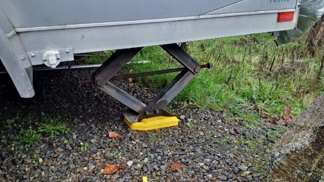

I ordered my trailer with 2 scissor jacks at the rear of the trailer.
After my conversion I found I needed two at the front. I picked these up from Princess Auto here on Vancouver Island on sale for 1/2 price - $49 Cdn for the pair.

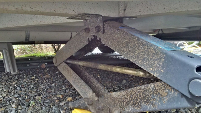

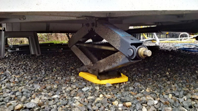

You can see that these mount on a lateral frame member so they run front to back on the trailer.
These work well for me. You should be able to find something similar locally.
Hope this helps!

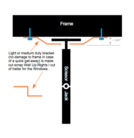

nitro_mt_racer wrote:Collapsed height on those scissor jacks is around 4". How are you guys not tearing these off the frame?
