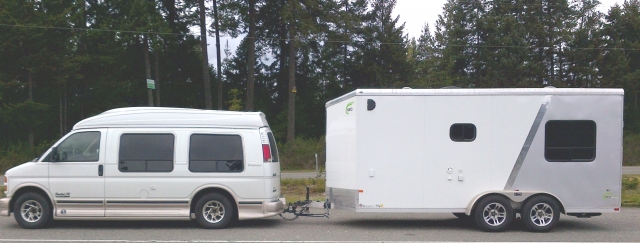

I bought my trailer "off the lot" so it is 7x16x7 with the 2' v-nose. You can see how the trailer kinda "tucks" behind the van in this picture. Interestingly I asked the dealer why the 7' ceiling vs. 6'6" (which is what I was really wanting) and he said it was because they could load a smaller trailer inside the bigger one - 2 for the price of 1 as far as shipping is concerned. I'm glad we went with the 7' ceiling. After insulating the floor (inside), we still have lots of headroom and the rig does not feel claustrophobic at all.
As far as drag, reduced gas mileage, etc., I have no idea. We just go.
