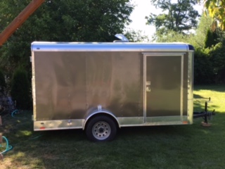

Picked it up Saturday.
1' 6" plus or minus above 4runner. Pulls nice, just dont like wheels are wider

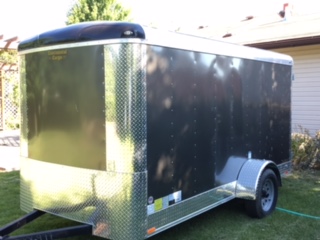

Postby fourbtgait » Sun Jul 09, 2017 8:22 pm
Saturday still
fourbtgait
Posts: 207
Images: 16
Joined: Tue Dec 02, 2014 4:17 pm

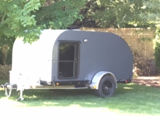

What it replaces
fourbtgait

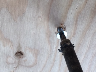

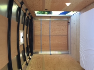

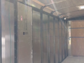

Postby fourbtgait » Sun Jul 09, 2017 8:31 pm

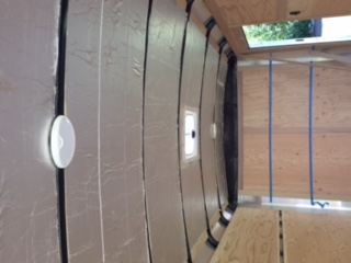

Sundays work.
$300 worth of iso insulation.80% completed today. Took interior ply off, insulated, replaced ply. Big help in that wall ply was screwed on. No, I have not foamed the nose, roof ribs or door channels yet. I am waiting till final decision on windows, locations, lights, cabinets, water heater/tank, etc. but for now doing the majority helps for summer camping.
Walls are R6, roof will be R9.
Looking at putting a window in the rv door, insulate it if its not.
Will post the Benroy on CL this week, sell it for cost. With or without trailer, their call.

Re: 6x12 build
Postby fourbtgait » Sun Jul 09, 2017 8:35 pm
More from Sunday. A 5 beer day, lucky it was on 98* today.
fourbtgait

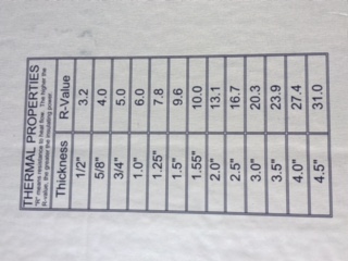

Re: 6x12 build

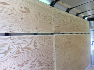

Postby fourbtgait » Sun Jul 09, 2017 8:37 pm
Typical, I cannot blame them. 17" wide, cut ply 16". Otherwise you waste money.
Probably put 1/4" birch beadboard over it.
