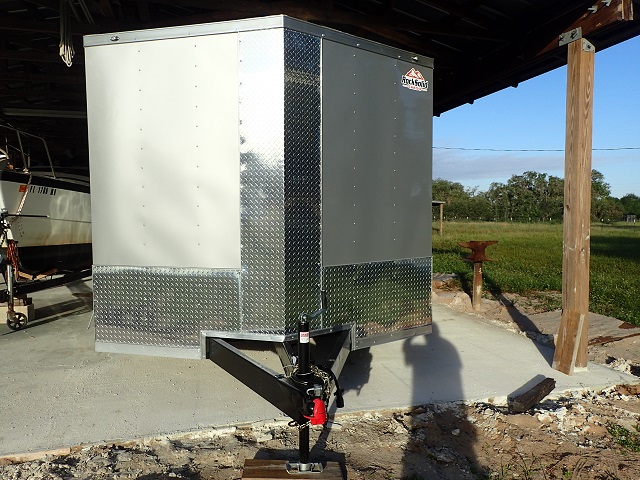

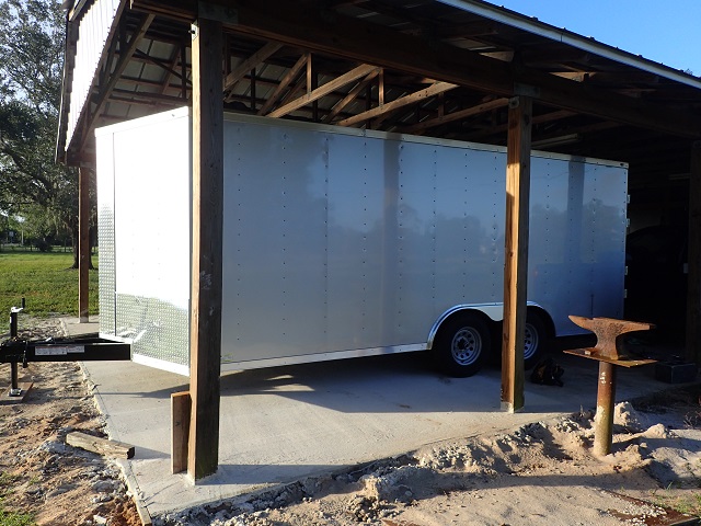

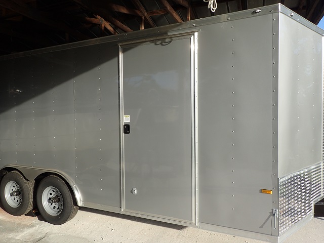

First post of a pic of the trailer. It is a 8.5 X 18 Rock Solid Cargo trailer from Douglass Georgia. Tandem 5200 lb axle with radial tires, .030 Aluminum skin, 1 x 1 1/2 steel tubing in walls and ceiling, floor joists on 12 inch centers, wall on 16 inch centers and ceiling on 24 inch centers and is slightly arched so the ceiling is not totally flat. Roof is one piece with no vents or holes. Extended tongue, V front, barn doors on back and we had the 36" entry door moved to 30" from front corner. Also got exterior led running lights on trailer. Empty weight 3000 Lbs.

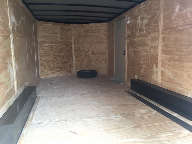

Here is a pic of the inside of the trailer before deconstruction.

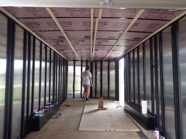

Here is the insulating of the ceiling. One inch of insulation on ceiling with Strips for nailing 1/4 lauan to ceiling.
We will be putting 2" of insulation in the ceiling and 1.5" on the walls. We have 1" between the ceiling trusses , they stay up by themselves. Next we will screw wood 1x2 strips into the steel trusses every 2 feet running the full 18 ft of the trailer put the 2nd layer of insulation between the wood strips and then screw the 1/4" lauan to the 1x2 wood strips. We are using the polystyrene rigid 4x8 sheets cutting them as necessary.

Option 2 is what I chose when I converted our CT during the winter of 2014/5. Screwing the luan to the plywood strips creates a thermal break, so screwheads do not sweat like they would if you chose your option 1. Pictures are in my build link below.

Thanks for all your comments. Doug, I went with your suggestion about running the wood strips for the second layer of insulation. The area between the two center 1" x 1.5" wood strips is where I will run my electric for the ceiling lights. In this pic there is an inch of insulation installed and another inch will bring the insulation flush with the wood strips and it run front to back of trailer. The offset piece of wood you see at the rear of the trailer is because the wire for one of the running lights is right in line where it should go so we moved it over 2 inches. We used a laser to get the wood strips straight from back to front.

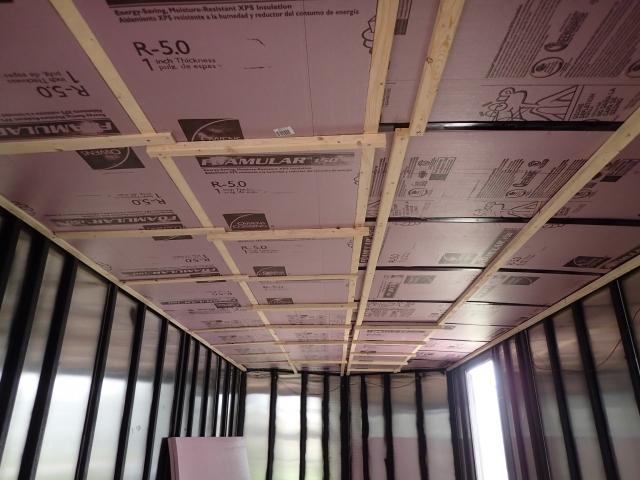

We got the second layer of 1" insulation in the ceiling over the holiday weekend. The first layer was put up running the width of the trailer between the trusses. This second layer was put up running the length of the trailer. We put gorilla glue construction adhesive on the metal ceiling trusses, put up the insulation and held it tight by screwing wood strips temporary across the insulation until the glue dried.
Putting gorilla glue on metal truss.
Ceiling with wood strips holding up 2nd layer of insulation.
