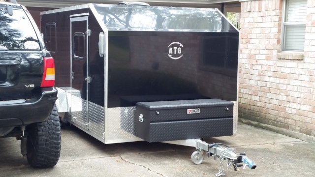

sodatrain wrote:Trailer looks sharp! Love the toolbox. Did you want black or was it available? I'm leaning white to keep it cooler in the summer. Black would be way better looking!

Black was a requirement. Had to match my vehicle. But yes, will probably require more A/C to keep cool.

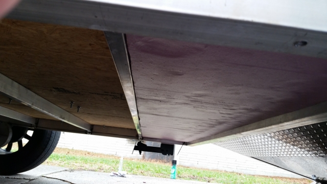

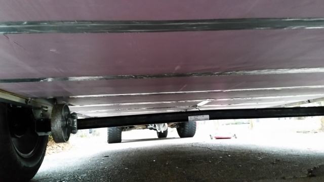

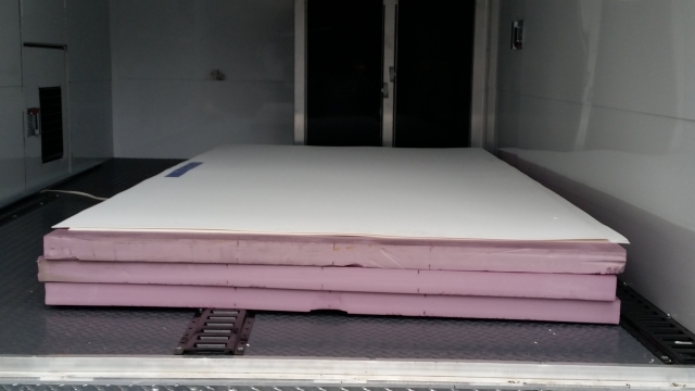

CoventryKid wrote:For our current trailer, I used 2x2s and 2" rigid pink insulation ON TOP of the floor, so lost a couple of inches of inside height (started with 7'). But then I had to deal with 2" higher floor at side door and rear ramp. Not really a biggie, but I have often thought I should have done what you are doing. There's all that space down there - perfect spot for insulation, etc.
I'll be interested to see how your install goes.
You don't need to cover the insulation. I painted mine, with UGL drylock to keep bees from drilling holes in it. As for dirt they stay fairly clean.onlyridepark wrote:CoventryKid wrote:For our current trailer, I used 2x2s and 2" rigid pink insulation ON TOP of the floor, so lost a couple of inches of inside height (started with 7'). But then I had to deal with 2" higher floor at side door and rear ramp. Not really a biggie, but I have often thought I should have done what you are doing. There's all that space down there - perfect spot for insulation, etc.
It definitely would have been easier to go on top but my trailer is already pretty short so trying to save as much inside height as possible.
Got all the 2" in today. Probably be a few days before I get to work on anything else. I am stressing about the walls. They have 1" between the studs but just sandwiched between the inner and outer aluminum skin. I could just go over the inner skin but I like the clean look of the walls. Removing it is a pain, whatever adhesive they used on the backside needs a chisel to get it off.

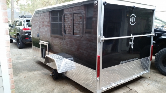

Finished this part today. And from here you can get a better look at how it rolls without the tires on.
