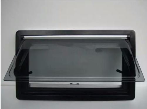

I do not have an awning over the window, but the emergency exit window I installed opens outward for normal use (ventilation) and effectively the window becomes the awning. In an emergency, it releases on the hinge and you can climb through. I use it all the time in the rain (they come with quick remove screens to keep bugs out). Find a window like that and you get two for the price of one. :-)
In any case, I think it is a good idea to have a secondary egress if someone barricades you in since all the doors open outward on these campers.
If you do not want an Emergency Exit window for whatever reason, they also make RV Windows that open outward the same way. Meant for opening in rain. They look like the pic below. No need to take anything down for transit. They are the same price as the Emergency Exit windows so I do not see the point, except you may be able to find them in a smaller size.
Sorry I did not answer your specific question. This is just an alternative to the window specific awning you asked about. At camp, when all set up, that window is under my main awning anyhow, but it is nice when in situations where the main awning is not or cannot be deployed (overnighting in a Walmart parking lot for instance).

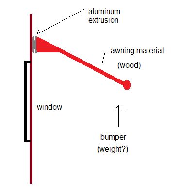

First thought I had is a simple frame from PVC and some Sumbrella fabric with a couple of screw eyes on the trailer (hooks sticking out at eye level makes me nervous).
I can't believe what "they" charge for a tiny window awning..................
Those aluminum side table extrusions cut to length might work nice with some thin plywood or plastic or other stiff material. Mount the female(?) half above the window and the other half to the awning material at the angle you want. Would be cantlievered and not even need support legs. On and off in an instant. Add a protective bumper (and maybe weight so the wind doesn't blow it off). Crude sketch below.
That is what a cheap skate mad scientist wannabe comes up with at first glance........

Postby featherliteCT1 » Tue Feb 12, 2019 7:12 pm
Ez,
Nice graphic … good food for thought …I am with you on the cheap :thumbsup: .
