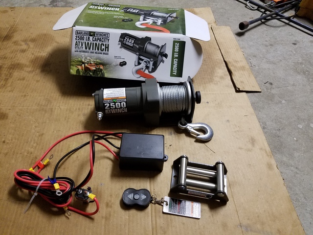

Postby flboy » Sat Feb 25, 2017 5:57 pm
Going to a Dual Sport event next weekend in the CTC. I'll have some in use pics. I received the winch today for the bed system. I still have to get a few pulleys and then I am going to try it out. It will still lbe a few weeks before I can install, but I am itching to try this.
The winch seems nice for $59.00. It even came with a remote control and solenoid box. I'll be able to lift and deploy the bed wirelessly (assuming it works). Now that is cool! 8)

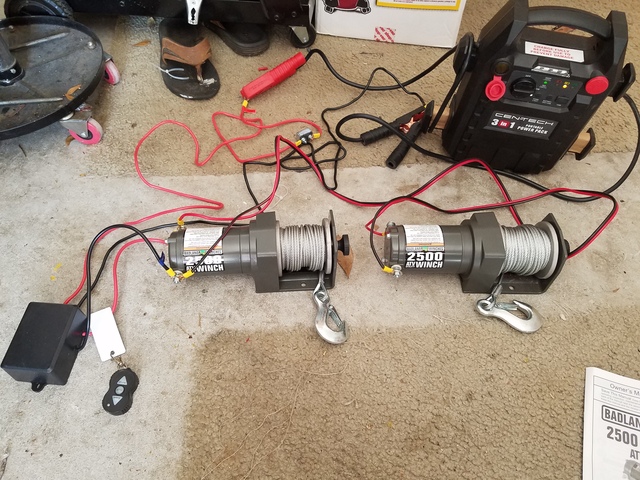

Postby flboy » Sat Feb 25, 2017 8:29 pm
I have been thinking about this and I can simplify the pulleys and installation if I use two winches and program them to the same remote or use one solenoid box to drive both? They only will be moving the bed 2.5 feet or so... so I am thinking that if they have the same current source the rpm/gear ratio being the same... they should not have time to get out of sync if the tolerances are close? The gear ratio is 153:1... that is some serious reduction.
The motor with no load runs at 10A. 132A for 2500lb and 55A for 1000 lb.. That being the case, these winches are going to only be lifting ~100lb max each... so the relay box I'd think would be fine driving both with this limited weight. I bet the box would never see more that 50A..
Anybody have a thought on that? This would seriously save me from having to have multiple pulleys and a cable running underneath the trailer and in this case, the winches would be inside too. I was also going to have to take the capstan apart and modify it to take another cable anchor... this will save that also.
I think I may order the second winch and test them to see if I can get them to play on the same remote and/or drive from the same solenoid. I also need to check the contact current for the solenoids... if this is the same box they use on heavier winches, it may be able to take enough current to run both even if the were under more load ?

Postby flboy » Sun Feb 26, 2017 3:40 pm
I got the second winch for another $55, but I think this is going to simplify the lift pulley system. I tried to reprogram the remotes so both solenoids would run off one remote.... No luck. In fact, they would not even clear memory like they are suppose to.
I ran out about 5ft of line and they both seemed to retract at the same rate... so that is good. Should be an even lift.
I can drive both winches of the same solenoid which has a 50A thermal breaker inline. That should protect the relays if both winches together draw more that 50A. I don't think that will happen as they are going to be barely working to lift the bed. 5,000 lbs of lift with only 200 lbs to lift.
These winches are smaller than they look. I can't wait to get the pulleys and make this happen... maybe the weekend after next I'll have some time to actually hook this all up.
