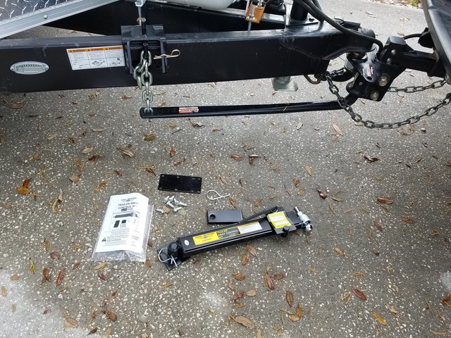

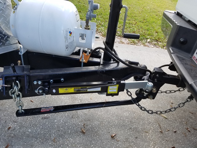

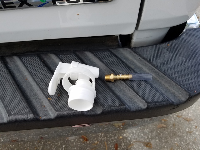

Packing up to head out tomorrow for an off-road dirt-bike event. I took the day off to pack up and etc.. So, I had time to put on the anti-sway bar today. It should help out with crosswinds and sway as large trucks pass by. I'll let you know how it works. With the load balancing hitch, sway is minimal now, but I like it rock steady.

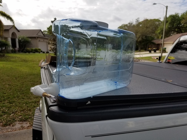

I also put the hose connector on the 2.5 Gallon drinking water container that I connect up to the hand pump.

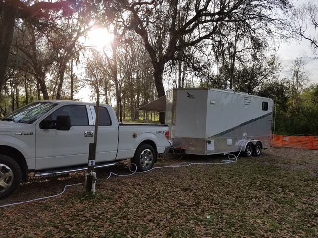

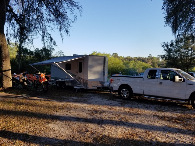

Back home after a great weekend adventure called Devil's creek. 150 riders and a 125 mile loop through the Withlacoochee State Forest each day.
The CTC did great except I had a water heater failure. The water has always been too hot for me... The pressure relief valve popped and started spewing hot water. I think something is wrong with the thermostat? I'll troubleshoot it later.. going to order some cooler thermostats in any case.. and I suspect that is what went wrong... I suppose the gas valve could be going also... or etc.. :-( If it starts to get into any $$, I am going to see if I can hack an On Demand water heater and make it fit in that spot... That is a better way to go.. They do sell On Demand heaters already built for that space, but they are very pricey.
I just shut off the gas to it and used the electric element... That worked well. Not sure why I ever turned the gas on to it since I had a power and water hookup. :roll:
Got a few pics of the CTC.. I had quite a few people at the rally come over and ask me about the trailer and they wanted to see inside... That was kind of neat..
