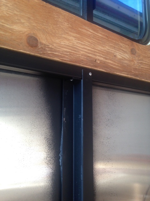

Postby travist » Wed Apr 17, 2019 11:58 pm
Ok, so I"m working on my cargo trailer conversion, which has factory installed windows.
Anyways, its been raining for weeks, with no sign of leaking at all, and I go into my trailer several times a week to work on it.
Then tonight I was in my trailer and ran across a tiny puddle of water on the floor. After pulling the walls back off where it was coming from and the insulation out, I was able to trace the water to the place in the picture. It seems to be coming in at the back bottom corner of the window somehow. I'm not sure what the triangle aluminum piece is, but I'm wondering if there is a screw that goes from the outside of the window into that piece or where else this water could be coming from. I don't see any clear signs of the caulking around the outside of the window, and the window was closed.
Thoughts? I checked that it wasn't above the window, say at the ceiling.

Postby McDave » Fri Apr 19, 2019 8:47 am
Leaks can be tough to track down. Chances are good the actual leak is not where you observed it coming from. The water can and will migrate in crazy ways.
However, since there was a hole cut in that area it would be the obvious place to look. So I guess I would start with the seal around the outside. If it looks to be correct, no gaps between the seal and trailer skin. Then make sure the weep hole or drainage holes are at the bottom and are clear. If the window is held in place by the inside trim ring only, it may have been able to take on water while the inside wall was off for insulation. When you re-assembled it and pulled it tight the water was dispatched and pooled at the corner and then the floor. Maybe. ... So it may be tough to re- create the exact conditions to make it leak and be able to see it. If you can let it dry out, reassemble and then leak test with hose sprayer and check you may not have a leak again. Or, you may need some more Dick Tracey work...
Good Luck
