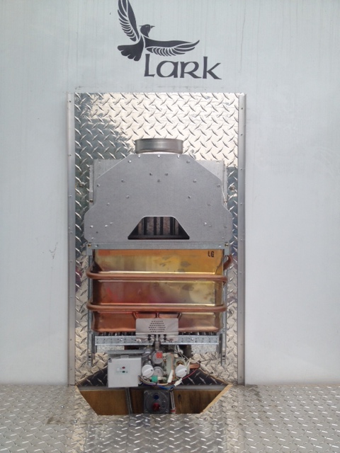

Above is the older water heater

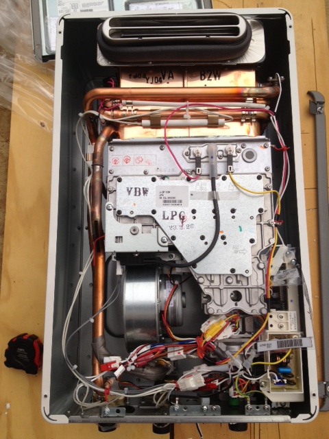

Here are the guts of the newer water heater

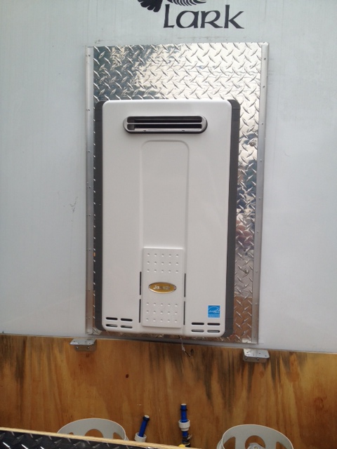

Picture of the water heater bolted to trailer front panel.
This large treadplate metal panel is attached with 1/4" stainless bolts about 1/2" away from the trailer skin
and that sucker will not come off , no matter what.

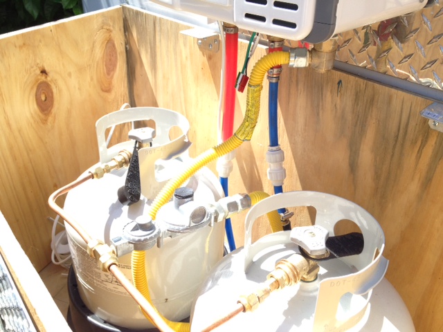

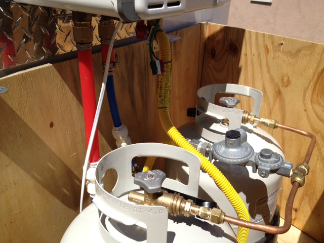

Guess which one is the hot :FNP The old water heater had 1/2" - this has the standard 3/4" MPT

Actually I think this heater should be able to function with just 1 tank, I will report back in the future
as it does dot use 180k Btu - till 7.5 GPM and I won't be using more then
1.1 GPM so that should put me around 26,000 Btu max ...
again the reason for the 2 bottles was due to the Propane Dealers recommendation that the single tank would FREEZE over
if just one bottle was used, especially when they were low ....the old heater pulled 150k BTU - and was not that adjustable.

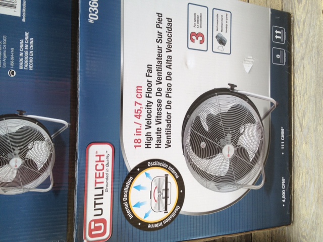

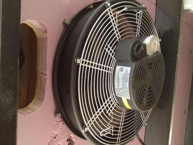

You guys gotta read my blog more...as I have more pictures over there.... :pictures: :pictures:
Here is the fan I have under the trailer 14" model 2,000 CFM & it kicks BUTT
ONLY USES 50 WATTS ... tested on meter myself
on the upper vent i have 4 x 80mm computer fans for 320 CFM
Everything is supper quiet :lol: :lol:
this fan was only $49.... funny I was sorta pissed off at the sky high price of the "OTHER FAMOUS BRAND"
strange because I'm spending money like a drunken sailor :money: :money:
photo 2-2.JPG (134.54 KiB) Viewed 3348 times
I got the 14" smaller model, even has 3 speeds
photo 1-2.JPG (136.05 KiB) Viewed 3348 times
Sorry just twist your head to see the box ...fan is from Lowes, 18" model is $79 I think ??
http://overthetopcargotrailer.blogspot.com/

Postby 8ball_99 » Wed Aug 22, 2012 9:04 pm
LoL I know you have plenty of power.. But just throwing this out there.. That fan uses 50 watts AC correct? If you do the math on that 50 watts AC @110v =.47 amps AC. That .46 AC amps is like 4.66 amps DC. This is not counting for the inverter losses.. Thats still not bad considering the air moved, But thats still over twice the power then the vent fans most trailers have..
A watt at 110v is much more then a watt at 12v.. Lower voltage always gets you higher amperage.. And the amps your pulling is what matters.
The air under the trailer is cooler because the ground is shaded. So the cooler ground=cooler air.. The problem in my mind with pulling air from down there is the warm air from outside getting pulled over the cool ground should either warm the ground or if pulling the air fast enough it wouldn't have time for the ground to absorb any of the heat.. Either way I don't think it would really help all that much with a small footprint. It wouldn't be any different then opening a window on the awning side of the trailer..

8Ball
I swear the 50 watt fan kicks ass...it works really good :lol: :lol: :lol: ....
it is 10 x better then my roof vent fans at 320 cfm and about 1.5 amps DC
I used to have a attic fan down there and it was loud as hell & sucked 300 watts & shook the trailer :cry:
