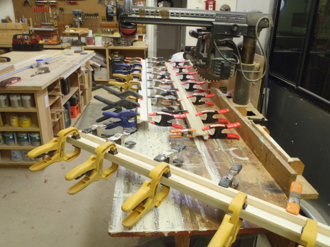

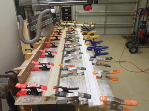

You can never have too many clamps
Postby pmspirito » Sat Sep 29, 2012 6:51 pm
I needed to add two small strips on the back of each piece of the door casing trim in order for it to fit right against the metal door frame. I used 45 clamps.
I had to do the same thing for the window trim around the front picture window.
