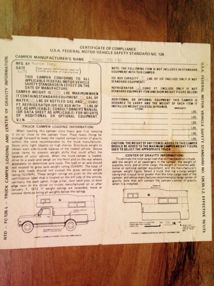

But you have a very mobile room to bring with, so distance shouldn't be an issue.
This is off that pick-up camper I'm scrapping. Back when straight axles and low horse power was the norm. Better than the 60's thou. I was trying to think of a truck with that much capacity. It's more than a 1-ton.
For me I'm more concerned with short wheel base to tow than what I can pull, and of course stopping it. My short is anything shorter than a full size pick-up standard cab and 8' bed. I'm going back to a pick-up someday- being disabled and medical expenses it might be a long time. My KK has been good, but since I got rid of my utility trailer it's not been what I need.
