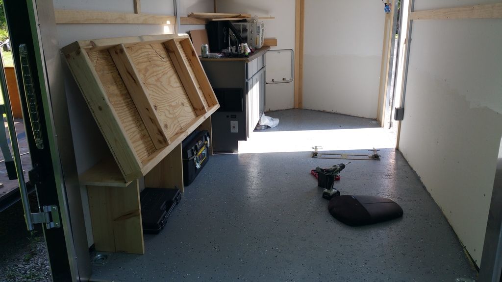

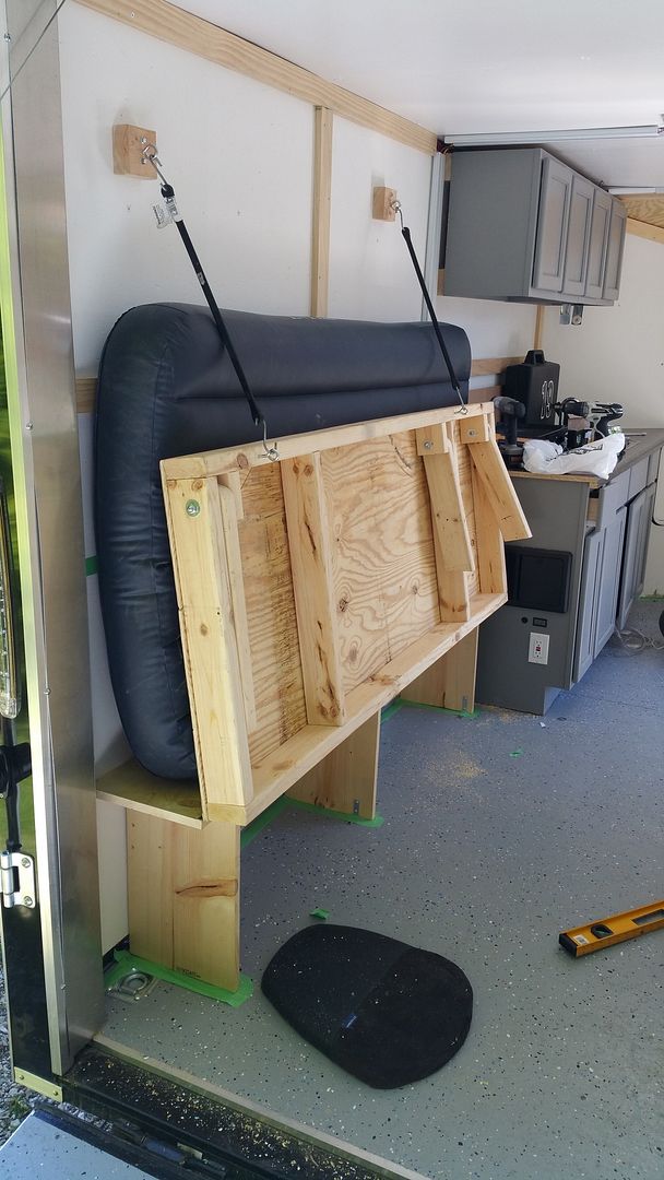

Postby Rocky5000100 » Wed May 27, 2015 7:55 pm
The anti-skid stuff is very grippy. I won't be concerned in the wet.

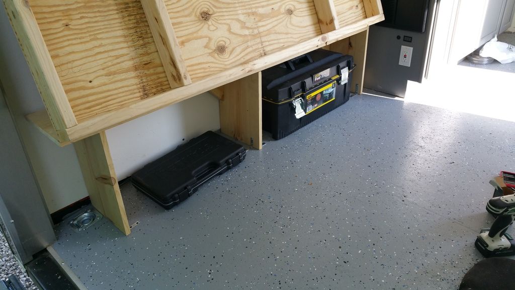

I got my bed installed today! I still need to make legs for it, but it looks like it'll work great. I have some extra carpet lying around I may line the plywood with to prevent the air mattress from tearing.
My toolbox and other things will fit beneath it nicely.

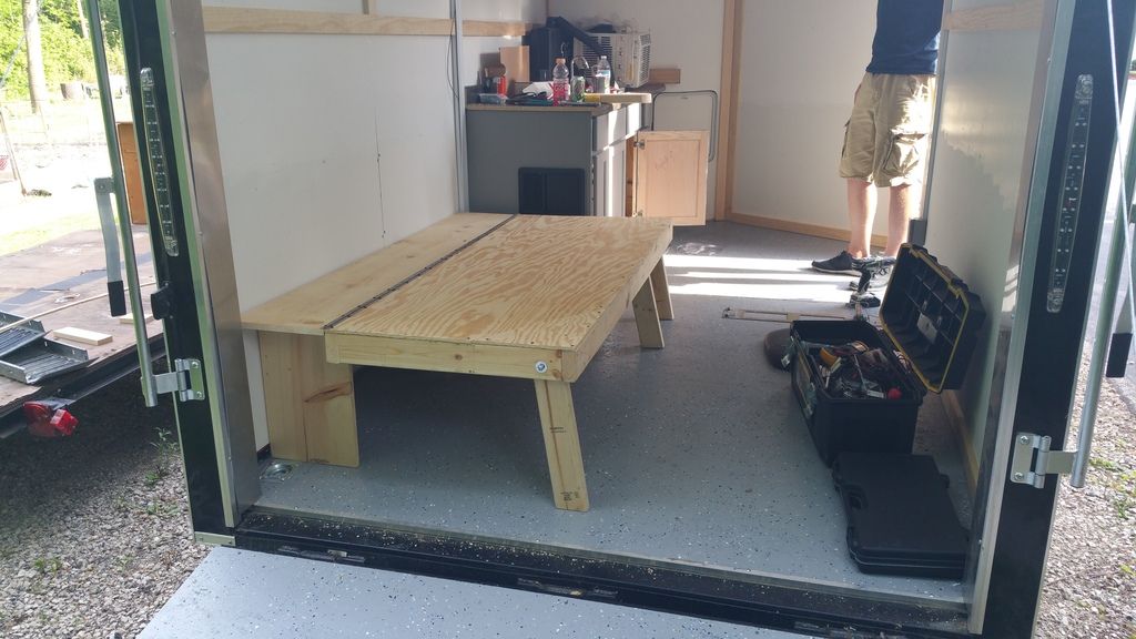

Postby Rocky5000100 » Thu May 28, 2015 8:43 pm
Yup.
Got the bed legs installed today. 3 seemed sufficient.
I also got the rear led strip lights installed finally!

Postby rebapuck » Fri May 29, 2015 3:00 pm
How will you hold the mattress in place?

Re: Rocky5000100's 7x12 Toy Hauler Build

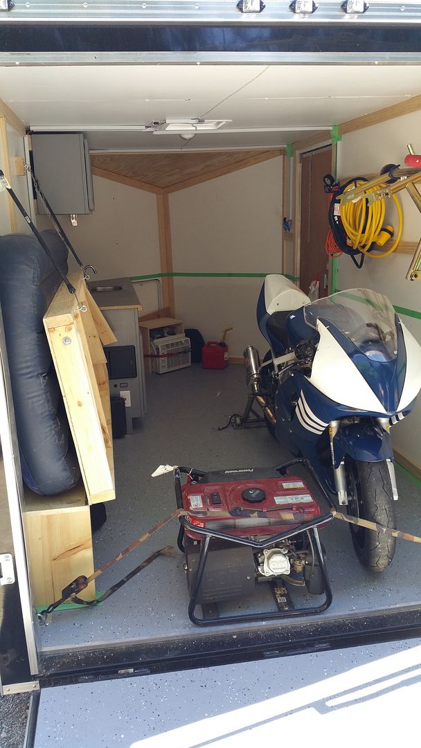

Postby Rocky5000100 » Mon Jun 01, 2015 6:06 pm
Like this for now :)

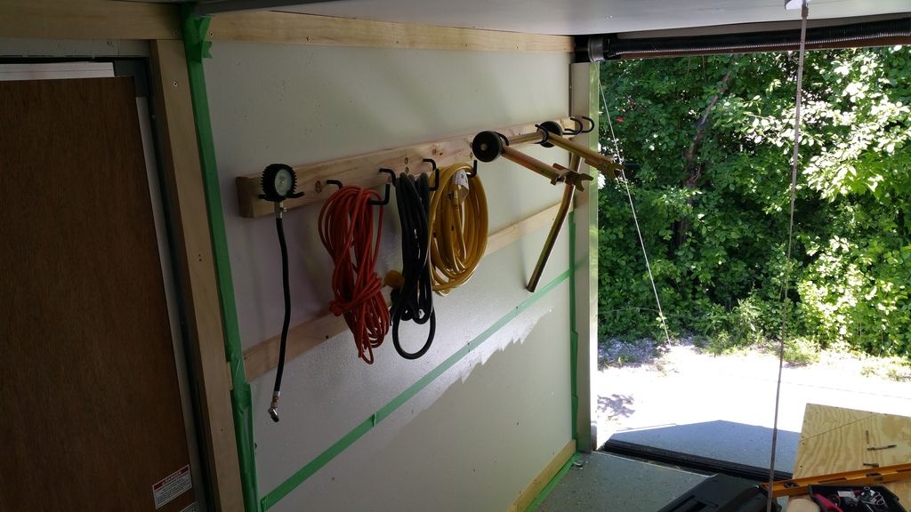

Finished up the wall rack for some things:
All loaded up for my track day at Road America tomorrow.

Postby rebapuck » Tue Jun 02, 2015 9:44 am
How will you keep the mattress in place when in use? Won't it shift every time you turn over?
On cold nights, air mattresses are not warm. You need to put something between you and the mattress. Carry a foam pad or extra quilts or moving pads.
Postby Rocky5000100 » Tue Jun 02, 2015 1:39 pm
rebapuck wrote:How will you keep the mattress in place when in use? Won't it shift every time you turn over?
I guess I haven't slept on the new platform yet so I'm not sure if it does. My dad has a bunch of leftover carpet I was thinking of laying down to provide a softer surface for the mattress to rest on.
As far as heat, I can bring my ceramic heater since most places have electric hookup ::grin:

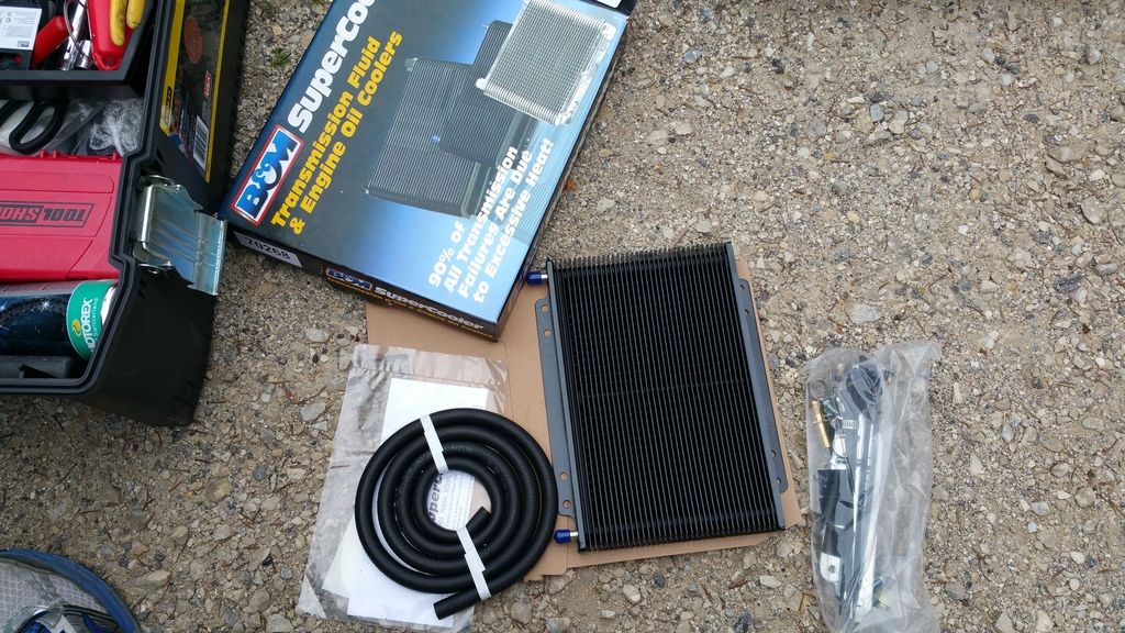

Postby Rocky5000100 » Sat Jun 06, 2015 3:48 pm

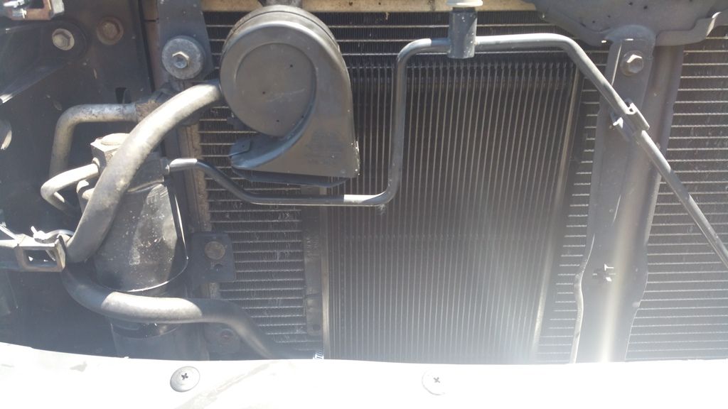

Finally got my B&M 70268 transmission cooler installed. This should help keep temps down while towing my trailer, as well as make it impossible to get the pink milkshake because I bypassed the stock radiator. Install was pretty simple, the hardest part was getting one of the skid plate bolts off! It rounded off so quick. I ended up using a dremel and a air chisel to get it off!

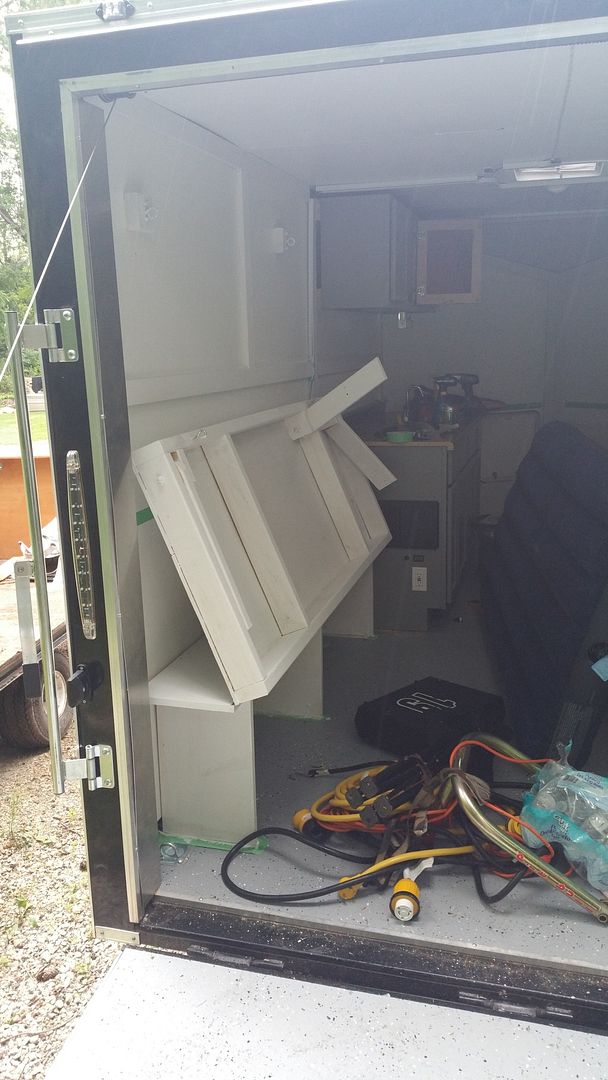

Postby Rocky5000100 » Sat Jun 20, 2015 6:10 pm
Primed all the trim wood and bed today. I HATE TRIM PAINTING. So tedious. Ignore the mess, it started raining so I threw everything back in.
Real paint will go on in the morning.

Postby Rocky5000100 » Sun Aug 02, 2015 6:32 pm
Haven't done a whole lot to the trailer lately...because I've been busy using it! It has been working great for this track season. Electrical has been flawless so far. The AC has been perfect on those 80+ days out. It is only 5000 btu, but if you put a small fan in front of it, it really cools you down. Turns out I can power my AC unit and my tire warmers on 15amp hookup! This is good news because it means I can buy a smaller 2000w inverter generator next year instead of the more expensive 3000w.

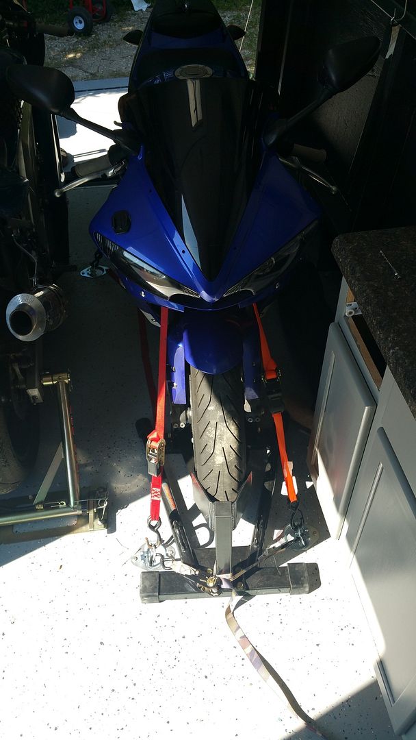

Today I installed a wheel chock and tie downs for another motorcycle. I wanted a chock so it is universal and I can carry anyone's bike. This tuesday I'm taking both bikes to the drag strip! I've never been to one before. $30 unlimited runs.
Old trailer sold today also . Bye bye.
