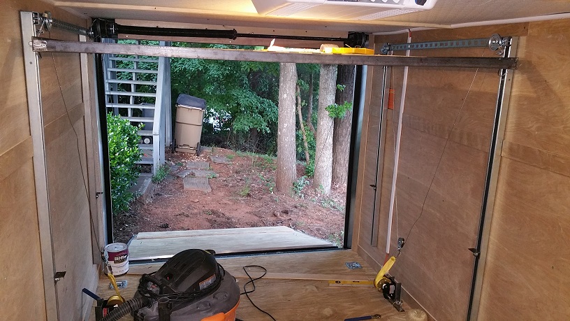

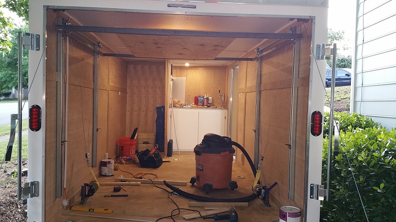

Here is where I am at today and the bed I am building. :beer:

Postby flboy » Sat May 14, 2016 11:13 pm
Very Nice. I thought about that design also. I have seen it on Pinterest at some point. Nice job! :thumbsup: :thumbsup:
I am going to do the rails and guide like yours (except only run the channels down 3.5ft where the bed with rest in the down position), but I am going to try the gas struts before I try the cables and springs.

Well I cheated I built removable winches and I pin the bed in the up position so I can get my bikes in. Next project is the wheel locks then floor paint. hopefully this week will go well so I can relax a little next weekend. :thumbsup:

Re: My Evil Plan
Postby flboy » Mon May 16, 2016 9:02 pm
That is cheating! :thumbsup: Nice idea though! Did you get the winches at Harbor Freight? They had some nice deals on some light winches.
Do both winches run at the same time so the bed goes up even? If you had one side of the cables go through the floor to a pulley underneath the trailer and across to the other side under the chassis and back up through the other side via a second pulley and figure out how to modify the winch pulley to wind both cables at the same time, you could use one winch and leave it permanently mounted. That would be cool!

Postby chiefairwrench » Tue May 17, 2016 4:10 am
That would not be difficult. No I had to winch both sides my wife helped but can do on my own just have to do one side then the other but very easy.But for my test run it will work great and i like the under the floor idea. :)

Re: My Evil Plan
Postby chiefairwrench » Sat May 21, 2016 7:23 pm
I modified them so I can lift the bed pin then remove the winches to give more room for the bikes. :)
