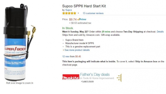

Postby flboy » Fri May 20, 2016 11:37 pm
I ordered one of these from Amazon today. I am hoping this will boost the start torque on the 6000BTU AC so it will start on the Honda Eco setting. My understanding is that this should boost the torque allowing for a quicker start an less current in rush. I'll give you the first hand review if it does work. I do know the Honda won't kick the air conditioner over when in ECO mode and I really want to use Eco mode so it will idle when the AC shuts down and only idle up as loads demand. :worship:

Re: Hard Start Kit
Postby lrrowe » Sat May 21, 2016 11:58 am
flboy wrote:I ordered one of these from Amazon today. I am hoping this will boost the start torque on the 6000BTU AC so it will start on the Honda Eco setting. My understanding is that this should boost the torque allowing for a quicker start an less current in rush. I'll give you the first hand review if it does work. I do know the Honda won't kick the air conditioner over when in ECO mode and I really want to use Eco mode so it will idle when the AC shuts down and only idle up as loads demand. :worship:
I will be watching for your results with this one.
