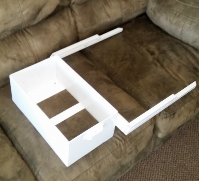

Postby Iconfabul8 » Thu Jul 13, 2017 2:21 am
Doing a little messing around with the TNTTT gallery. As for the picture, you will have to guess for now. Completed project pics coming soon.
Sorry it is a little out of focus. :(
