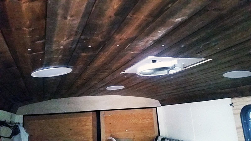

Here is a picture from last weekend, lights wired, fan wired, ceiling insulated and DONE:
trailer ceiling complete.jpg (116.75 KiB) Viewed 2030 times
My cellphone hasn't been taking good photos lately, so its a little hazy/glary. Flash looked like crap but if I turn the lights on the glare makes it impossible to photograph :D

Postby flboy » Wed Apr 18, 2018 9:03 pm
Happy Birthday!!!!! :P :P
Ceiling looks really nice. I like that look!

Postby McDave » Wed Apr 18, 2018 11:56 pm
[quote="Mark959"]It's my 30th birthday today... Crazy.
[quote]
30 Again? That's alright, I've had 29 anniversaries of my 29th birthday myself. I'm getting pretty good at it now.
Happy Birthday, Mark.
So, Hey! I really like the ceiling. Has kind of a nautical feel to it. Nice job!
