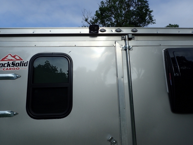

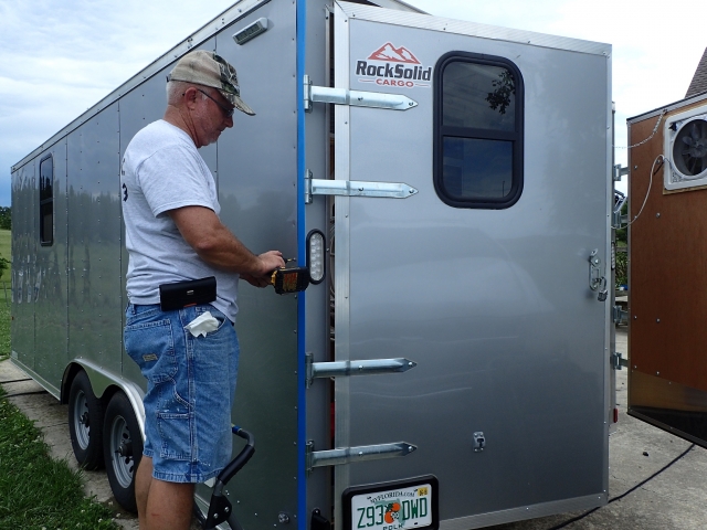

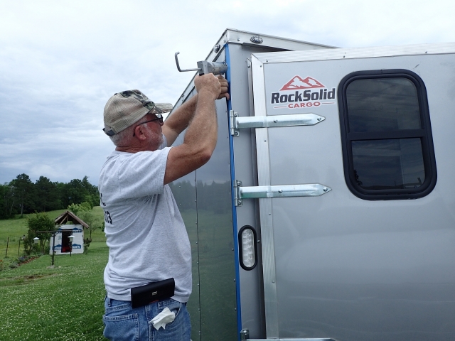

We are now in Albany Ga. for the 3 day weekend. We do not need a wheel on the door as the awning does not go over the door. Don we did buy a couple of springs for the awning tie down as we already had the dirt anchors and the cinch straps. Thanks for the ideas.

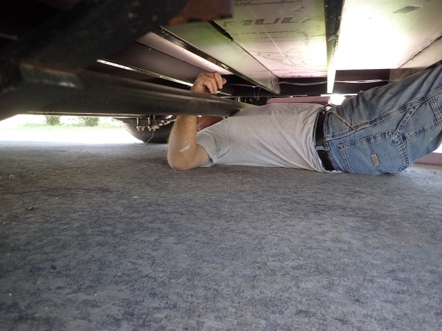

Our next project was to put 2 inches of insulation under the floor between the floor joists. We cut the insulation about 11 inches wide and 75 inches long as our floor joists were about 11.5 inches apart. After using a table saw, a hand saw, a box knife and a saber saw we can saw that the best thing to cut the solid insulation with is a saber saw with a aggressive wood blade. We used gorilla construction adhesive to glue the insulation up with. We put a good bead about every foot across the insulation. Pushed the insulation with the glue up against the floor, held it for 30 seconds and let go and it is still up after 150 miles of travel.

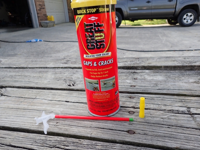

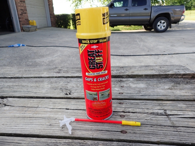

We next used expanding foam to fill all the gaps between the frame of the trailer and the insulation. We did remove the end of the yellow end of the tube that attaches to the spray foam can. You do not need this end which keeps the foam from getting hard in the tube if you are going to use the whole can. It is also easier to control the foam amount without the yellow end on the tube.
Tube as it comes with the can
Tube with end removed. Just hold the red tube and push against the yellow end with a knife or thin file and the yellow end will pop off.
We used a mechanics creeper to move around under most of the trailer. We used the trailer jack to raise the part of the trailer we were working under. But some areas like the area between the axles just do not move and it is tight.
