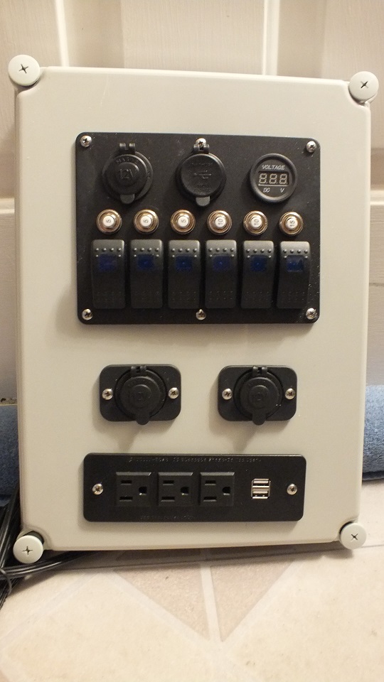

It's been a while since I made any progress on my build, and it may be a while longer before the wiring gets done. I've decided the limit the majority of what I thought I would do. I have finished installing the electrical panel face devices. I added a couple more cigarette lighter receptacles. That way, I will just install two opposite my bed. I will install one of the LED lights on the wall just above my bed so I can reach up and turn it off. Th other will go in the front of the trailer. That's all the wiring with the exception of connecting the control box ground to the trailer frame.
I was going to build a wall just inside my cargo trailer rear door, but that would take about two inches or more of my usable trailer interior length away, so I will remove the trailer door, and build the wall where the trailer door would normally seat. That way I can install my teardrop door in that wall. I just have to figure out how to remove the trailer door that is now there, and figure out how to frame the opening so that it is fairly robust, able to withstand off road travel.
That is as far as I have gotten, mostly thinking how to do things simpler.

Postby bete » Fri Feb 23, 2018 12:30 pm
Love that switch panel, nice work. I might have missed it but where did you get it?

Postby CaleyAnn » Fri Feb 23, 2018 6:13 pm
Bete, Everything is from Amazon. I live in a kind of out of the way place, so locally it is nearly impossible to obtain what you need.
https://www.amazon.com/gp/product/B074R ... UTF8&psc=1
https://www.amazon.com/gp/product/B0002 ... UTF8&psc=1
https://www.amazon.com/gp/product/B00X3 ... UTF8&psc=1
https://www.amazon.com/gp/product/B075D ... UTF8&psc=1
https://www.amazon.com/gp/product/B073Z ... UTF8&psc=1
I initially cut lines in the box panel with an X-acto knife. I then took a reciprocating saw blade, sawing by hand along that line until it cut through. once I had enough room for a hack saw I finished up the line cut.
Holes were cut with a Forstner bit, then using a curved file, filed the opening larger until the cigarette lighter sockets fit.
I know the way I did things sounds time consuming and tedious, but cutting holes of any kind in this box creates too much heat with power tools, causing melting, and sometimes,as in a hole saw on a drill, chipping.

Postby McDave » Fri Feb 23, 2018 7:21 pm
Hey Caley Ann,
I really like that junction box and the switch panel is great! Have you ever used step drills? May have been perfect for this. I use them all the time for sheet metal and panelling.

Postby CaleyAnn » Fri Feb 23, 2018 9:05 pm
McDave, Just won't work with this type of plastic. Any high speed cutting device causes the plastic to melt, then once the cutting device is past re-solidifies. End up with a fused mess. Cutting it by hand eliminates this problem.

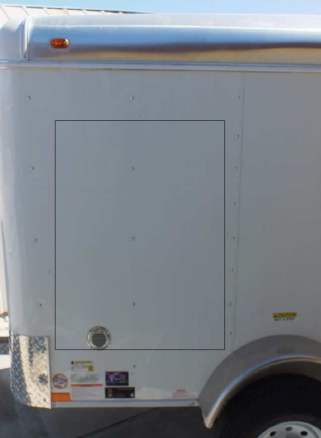

Anyone know if I can install a regular RV lock mechanism in my rear trailer door? I kind of would like to remove the lock bar setup, so I can add the teardrop door into that back door panel. It's just that this big lock bar handle is in the way. If it can be done, any recommendations on a RV trailer lock set with deadbolt.

i've seen rv latches installed in a cargo door with the locking bar still in place. i bought an rv door latch set and plan to install it a month or so when the weather is better. i will remove the door and open it up to insulate and maybe install a small non opening window while i'm at it.

I've done some more thinking about where to install the teardrop door, and think the rear just won't work either. Of course there really isn't an ideal place to install such a door on this tiny trailer. Bit I think I can just squeeze the door in on the driver's side of the trailer as depicted in this photo. I will have to cut part of a metal stud out, but will also have to frame the outline of the door between these remaining studs and the partial stud with 2x4's. The hard part is figuring out how to install those 2x4's to the existing trailer framework. Also, I have to figure out how to cut the opening with hand tools. I am guessing that I drill four pilot holes, and then use some kind of hole saw to cut the metal out. Probably need a hacksaw to cut the metal stud. Somehow I have to discover a way to have the hole in the outside, and the inside ply panel match up.
If you are wondering why the bottom of the door will be so high, I have to avoid the wheel well. As it is, the bottom of the door will only be a few inches above the interior floor.
This means my having to redo the insulation and the electrical work I have already done. I will have to move one of my intake vents over, but that isn't a big deal.
I would also like to mount a fixed step to make entering and exiting easier. Any ideas on a step? My trailer frame is only about 3x3 inch angle steel, so there isn't much purchase for welding or bolting it onto the frame.
