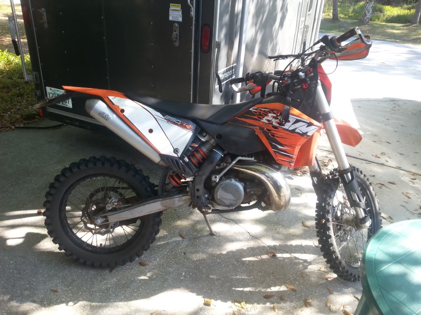

Postby Tommy B » Tue Mar 07, 2017 3:48 pm
Don, welcome back. orange looks so good in mud> :thumbsup:
Nice.
I had to pull the beast out after looking at those pics. Started right up. :thumbsup:
See you in May maybe. I may be up there in a weekend or two..
I will ride with a cast, what ever! :beer:
