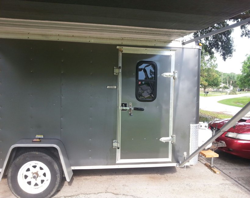

Tommy, Jscwerve just posted these pics of his CTC progress the other day. He was not finished with the prop up pole, but you get the idea. I have seen it done this way many times. It is a great option for one or two panels.
He mounted this way for hail protection. You could do the same and just pin at the hinge so you could also remove and move around some if parked in shade .
Also, you can easily adjust angle for best sun and maximun charge when it is lower in the sky. All good stuff.
I can't tilt my panels easily, so I just compensated with an extra panel. Plus, I am screwed if we get severe hail. I think my panels would take the marble size, but not the golf ball size hail we see once in a blue moon here.
You decide to go this route, let me know. I'll spec out a panel and charger for you, then I'll come over and help you install. No roof leak concerns either. :-)

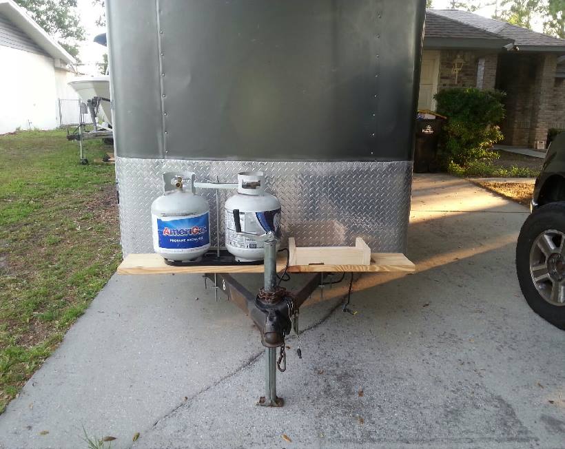

This is an older pic with out the battery installed but I think it would be perfect if it was above the LP tanks and battery. It would get very good exposure while on the side of my house. It would be good if it had tilt ability to the left some as that is best while it is on the side of my house. The sun really cooks there.
What you said about the tender vs. the Progressive PC. Yes I thought so too. Thanks for that info. No cords or tenders for me.
Maybe it would be cool if it could detach if needed an placed in or around the back of the truck for better exposure when boon docking if needed. :thinking:
but NOT necessary. Fold up or down. Maybe 2 feet above the tanks. But how to hinge there? Its curved as you know. :thinking:

One other spot would be on the awning side above the fender some. ( The other side is up against the fence when in storage ) Yes that has obvious draw backs but the awning is not deployed when in storage and there is a flat surface to hinge on. I will edit a pic in a minute, ok? I like the front mount better.

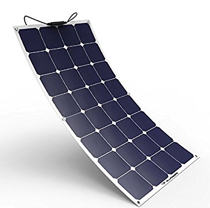

Maybe something like this bungeed down to the roof or hanging from the right side when in storage. Seems easy. :thinking:
ALLPOWERS 100W 18V 12V Bendable Flexible Solar Panel Charger Lightweight SunPower Solar Charger with MC4 for RV, Boat, Cabin, Tent, Car, Trailer, or Any Other Irregular Surface
Some people adhesive taped and dicored them to the roof so no hardware...just a thought. 169.99

Tommy B wrote:Maybe something like this bungeed down to the roof or hanging from the right side when in storage. Seems easy. :thinking:
Tommy, that panel will do the trick also.. many ways to make that reside on the roof and then remove as needed to position in the sun. Does that come with a controller for that price?

I read a bad review of that flexible one but all in all it got good reviews though. But after sleeping on it all and taking a look at it, It would be a pretty good spot just under the Haulmark logo. At the seem are 6 big screws or so that hold the cap on and they go through the C.T I think so it should be an ok spot to mount a modified bracket to account for the slight curve in the seem. It would be out of the way, up high, and close to the battery. Fold up, fold down, or maybe permanently folded out?
The left side faces East, From mid day till almost sunset that top and right side bake in sunlight.
That's the spot. Hard Panel. What to you think? :thinking:

On the flexible pad it does not come with a controller but this one is purchased with it for 20.00. And for 8.00 more you purchase 5 pairs of MC4 connectors.
I am still looking for the best easiest way. Directly on the roof would provide max exposure.
