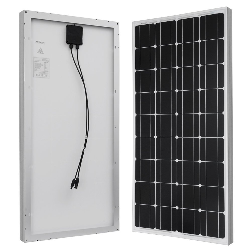

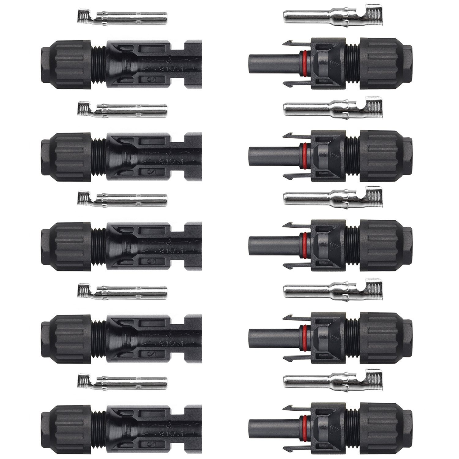

Tommy, that is way more than you should pay.... You can get good kits for much less. In fact, I have brackets for you I bought and never used. These aer the pieces.. and the panel is a high quality monocrystalline.. Can mount on roof or side as you choose. Also, well need to buy some good 6 or 8 gage wire to solder up to those connectors to attach to battery, then we can use the extra ones to make "jumpers: if you want to extend them out somewhere on the ground... up to you. They have the flexible panels for $169... could get one of those instead of the rigid ones... all else is the same. Look at the links.. what you see below is $153 plus tax... then figure about $25 for some good quality wire.. will be less that $180 with misc.. of course... at the end of the day, you have to like what you get.. not sure why they are getting $400 for than kit...
100W PANEL.jpg (86.51 KiB) Viewed 2224 times
https://www.amazon.com/HQST-Watt-Monocr ... +panel+kit
https://www.amazon.com/YueYueZou-Charge ... ar+charger
MC4 Connectors.jpg (237.5 KiB) Viewed 2224 times
https://www.amazon.com/Sun-YOBA-Pairs-F ... 7R8W46D5GE

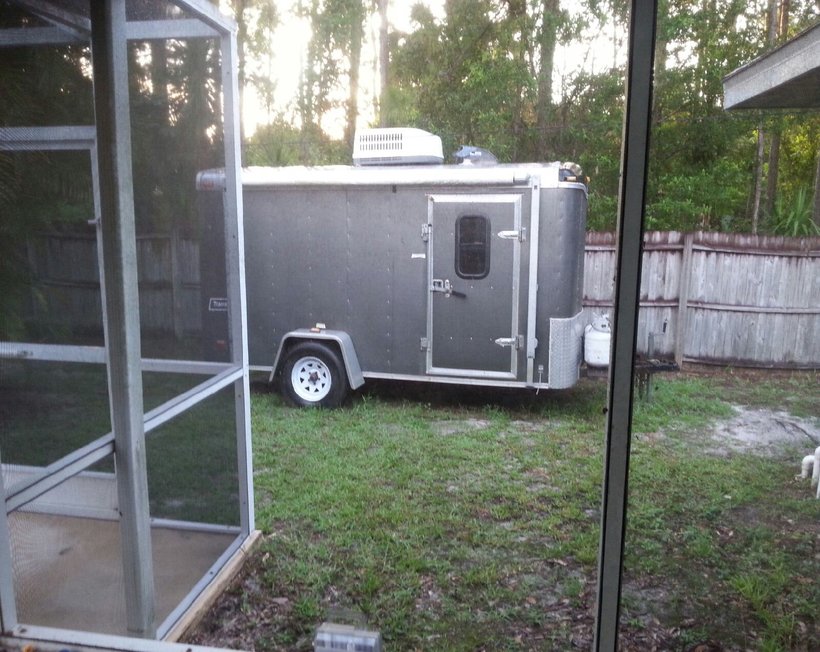

I would prefer ridged and on the roof permanently but I see no way of doing that with out screwing into and through the roof and into the supporting cross beams? The awning may be in the way for any side brackets. See previous pics above. Please.
The flexible one would work easy but it gets way to hot up there. You really could fry an egg sometimes and I don't see that flexible panel holding up too long up there. Some one on amazon reported one shorting and burning through and into there rubber roof. :shock:
Can we mount that ridged one roof top? With out screwing into the roof. Please let me know and I will place the order today.
It could maybe mount/hinge right under that awning tube. I might use chains instead of long pole to support when folded down. maybe up front under the Haulmark logo?

Tommy, I don't see any way to mount on the roof without a few screw holes. If you use dicor tape and the lap sealant, you are not going to leak. I have some ideas to minimize the screw holes. If you want, give me a call this evening and we can toss around some ideas.

I am heading to Buffalo NY on business Thursday and will be back Sunday...I have a off Day Friday August 4 and Saturday August 5. I'd be glad to come over and help you get it all installed and hooked up one of those two days (whatever works best for you) . The whole job should only take 2 hours. Will that work? I have the brackets...
I will draw a pic of what I was thinking for the roof mount..The good thing with your CTC is that there is no ceiling installed yet. We don't necessarily have to hit the aluminum joists or frame.. we can install some wood between joists and anchor into that... I have tons of scraps.. In any case... there are a few ways to do it.. My idea is to install two rails rails that go across the roof in the area before it curves and just far enough apart for the solar cell to span, and then the solar cells screw into the rails. If you go back to my old build and this one, that is how I did it, except my roofs had/have square edges and I screwed the rails into the very edge part of the roof frame. We will only need a total of 4 less than 1/4 in holes since we can install nuts and locking hardware on the rails from the inside. (we can make a trip to Home Depot together the day we install to get the misc. hardware for the rails... should be <$25.00 and I may already have most of it)
You will like having that panel. I will keep your battery topped off and extend the useful life of it when parked for sure and at least extend the usage of it when boondocking with the fridge running so gen time will be down to a minimum when camping (maybe not needed on a real sunny day depending on shade).
BTW, I think we should install in such a way that if you ever decide to buy a second panel ... it will be just plug and play and no additional drilling into your roof (only into rails) or wiring needed except some "Y" connectors you can order on line for <$10.00 and install in 10 minutes. That is literally what I did when I bought a second panel for my previous build when I also bought the second battery.
This is a disease you know... you just have to know when to walk away. ;) ;)

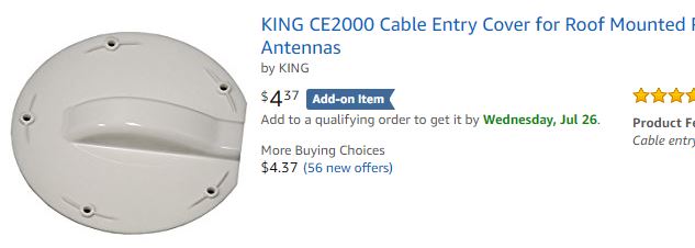

Edit: Tommy, almost forgot.... we need a hole to get the wires in and since you do not have a refrigerator vent... the following is one way and water tight using the same Butyl tape and dicor lap sealant. You may think of another way without penetrating the roof (side or etc..) but the two wires got to get inside to controller somehow.

oh yes I will order the cable hole cover. just like the pic
