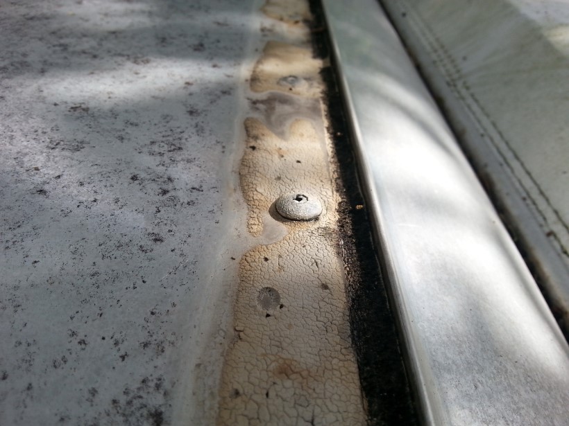

Take a look at the seam there were the lap sealant covers the screws. It is looking suspiciously in need of redoing as some of the screw heads are coming through the sealant. Also up towards the front the aluminum roof has been indented in a spot close to the seam and there is actually a gap between the sealant and the dicor seam. I did not see that until a day or two ago.
I think I should maybe redo the seams with some type of sealant and coat the roof with Henrys prior to mounting brackets, solar panels and cable covers. UGGG!!

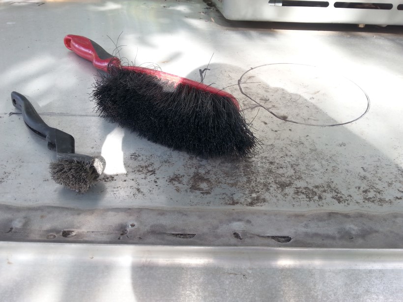

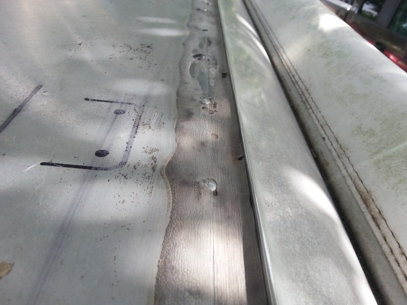

Postby Tommy B » Thu Aug 03, 2017 5:05 pm
Ok! Got it. I guess this is how I am going to do this.
Before and after.
Hit with wire brush and elbow grease. Pay attention to rotten black bubble voids. Brush em clean. Buff with alcohol. Isopropyl. Save the good stuff for your self your going to need it.
I will just redo the whole top side like this and then re Dicor. Just like the factory did. Whether or not I coat the roof afterward I don't know. I use this 5-10 times a year in the cooler months and that will not change any time too soon. You need 24-48 hours cure time and I was hoping to complete this Saturday also.
Anyway this trailer roof is 10 going on 11 years old and yes the sealant is rotted some.
Hope this helps some one. :beer:

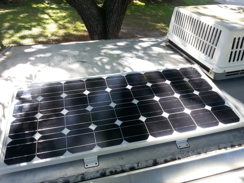

We got the solar panel mounted up and connected. Tommy has solar!
Don (Flboy)

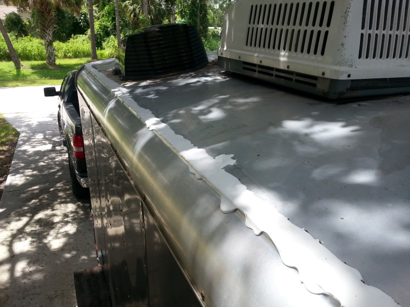

Postby Tommy B » Sat Aug 05, 2017 1:37 pm

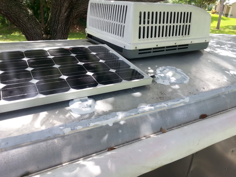

Thanks. More pics Trailer is back to normal. I'm BEAT. Thank you Don! sorry so short. Heat killing me Working on rear truck doors now. Neither one will open. :x
I went crazy with the dicor. Ran out and went back but they only had white left jeeze look at that. Oh well it will NEVER leak in my life time. :thumbsup:

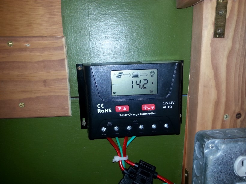

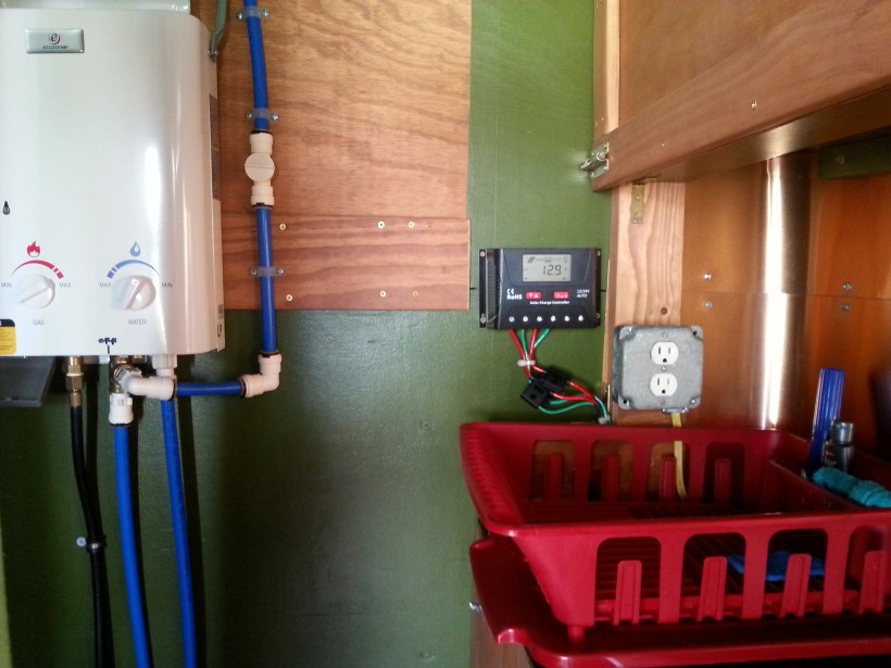

No trips for me featherlight until it cools down some. I cant wait to be back in the forest again.

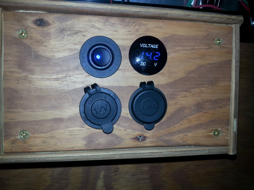

So hey man, check out this voltage reading. I have never seen it that high but once when the battery was 12.2 and the Power Center shore power was charging it.
BUT, the battery is at 100% according to the controller and it is still feeding the battery .44 volts. Its only a 12 volt battery. Is 14.3/14.4 going to be ok long term?
The other battery meter says the same basically. I am socked I tell ya, shocked :shock:
Not going to explode is it!
