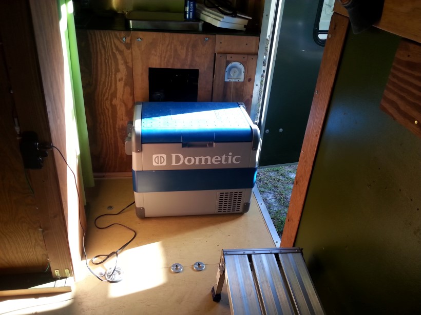

Postby Tommy B » Mon Aug 07, 2017 4:58 pm

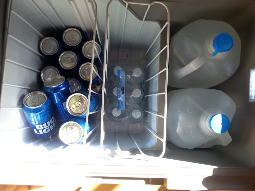

Well It begins. All the things An Irishman needs. And he needs them cold. 8)
Note the Sun, it now 6 pm here. Clear mostly. The beer was cold. The gallon water 79 degrees, in house storage. The bottled water was trailer hot as it was in a storage bin, in the trailer. The initial dometic temp was 79 degress when I plugged it in and just dropped from there quick. But...
See next three pics :thinking:
one second.
20170807_180453 (Custom).jpg (136.32 KiB) Viewed 2313 times
20170807_180359 (Custom).jpg (104.79 KiB) Viewed 2313 times
20170807_175948 (Custom).jpg (100.54 KiB) Viewed 2313 times

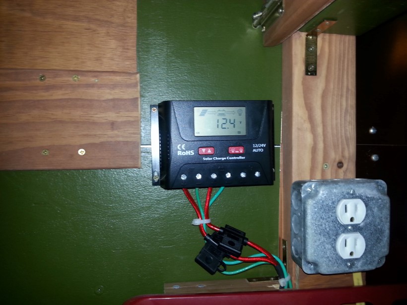

Re: HALLMARK 6X12 CONVERSION
Postby Tommy B » Mon Aug 07, 2017 5:07 pm

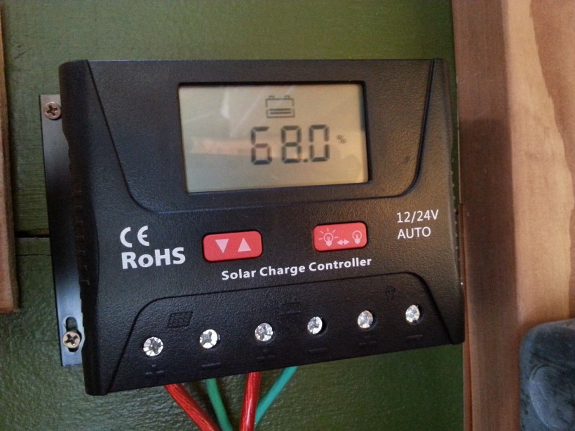

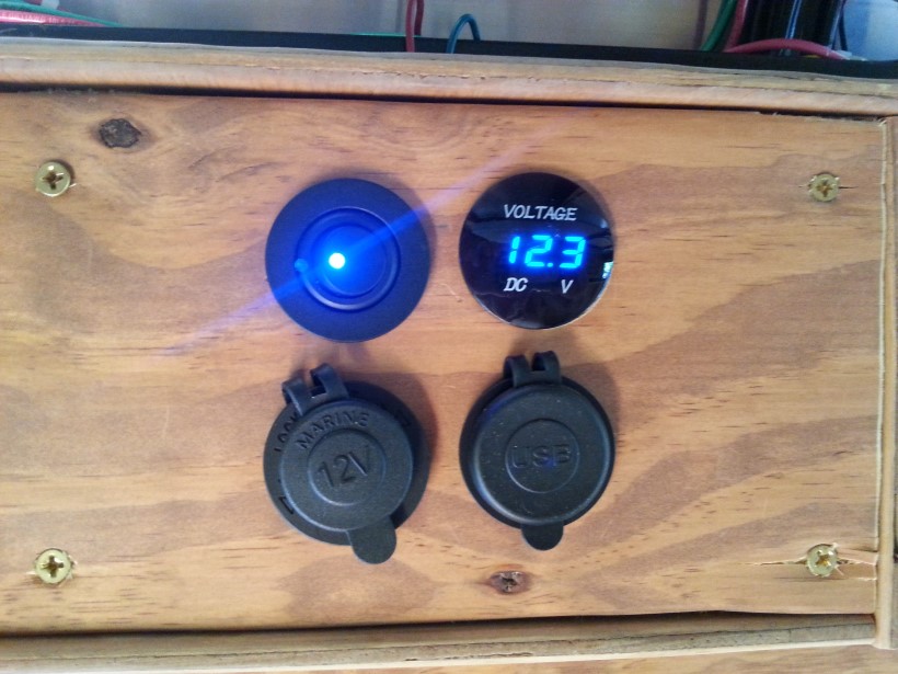

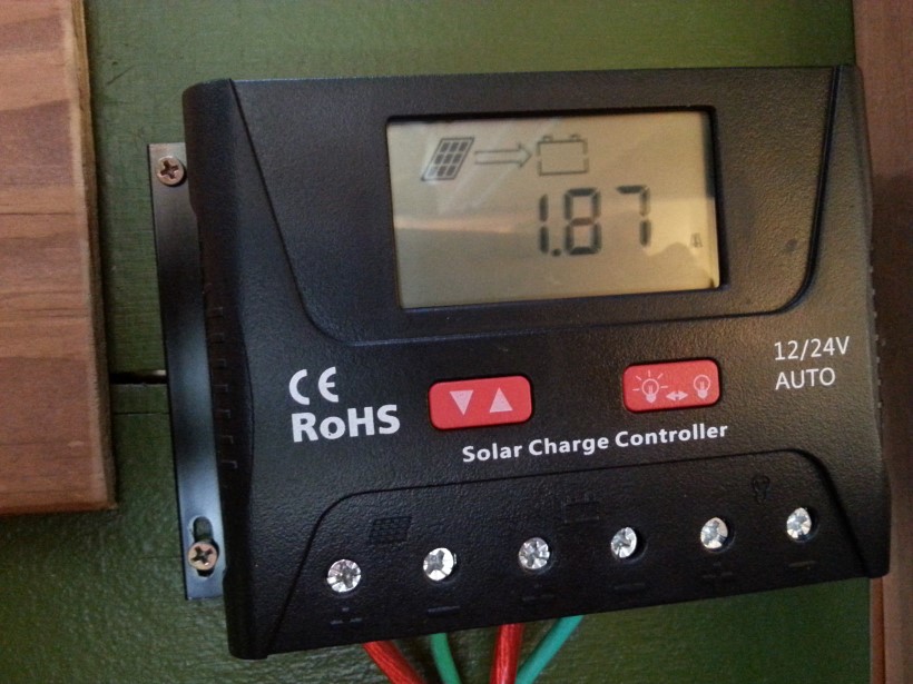

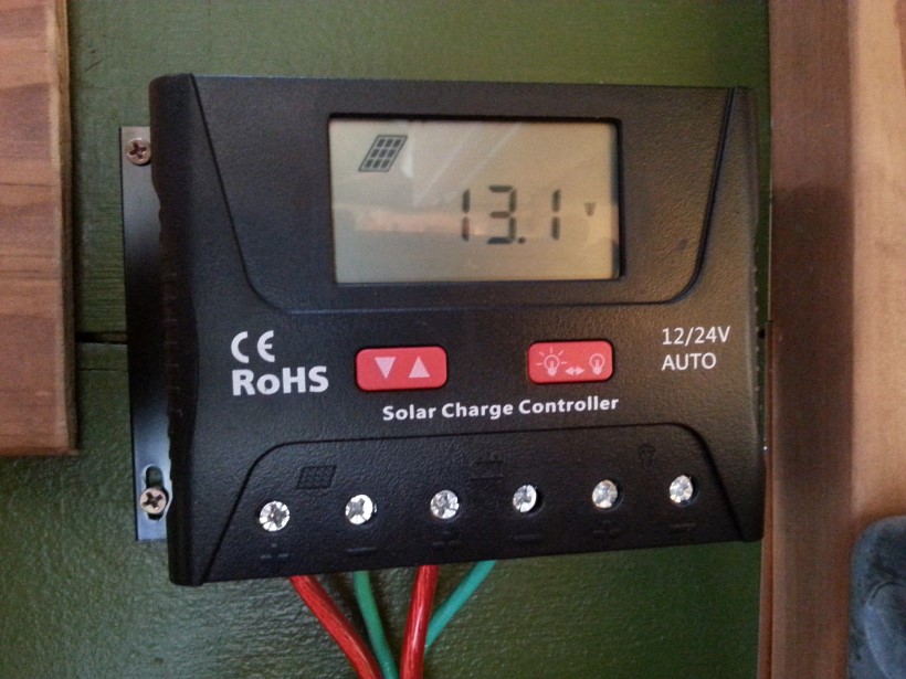

It seemed to put a whammy on things but I am not sure.
Battery @68% but that might not be reliable.ok
1.87 amps ( I got it! ) going in from panel.
I don't know what 13.1 volts means.
It also gave the battery temp and I think It was 40 Celsius. Just info.
My other volt meter said 12.3. :thinking:
I will check back.
Thanks.
20170807_180146 (Custom).jpg (122.37 KiB) Viewed 2310 times
20170807_180131 (Custom).jpg (120.13 KiB) Viewed 2310 times
20170807_180153 (Custom).jpg (117.84 KiB) Viewed 2310 times
Postby Tommy B » Mon Aug 07, 2017 5:09 pm

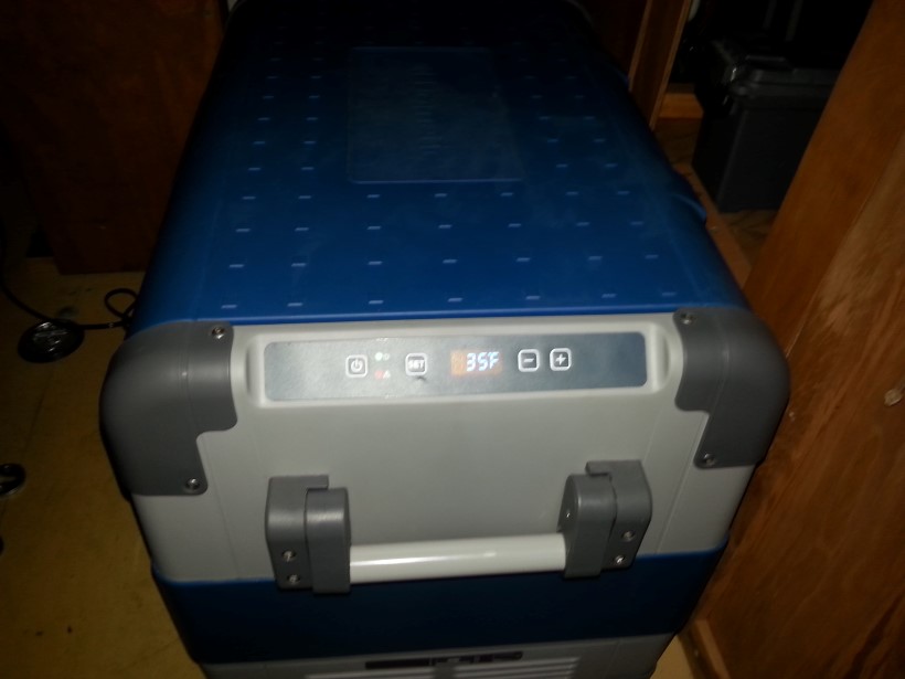

That one and that seems like a big drop but I will monitor
20170807_180342 (Custom).jpg (118.79 KiB) Viewed 2309 times
Tommy B
Posts: 891
Joined: Sun May 08, 2016 4:37 am
Postby flboy » Mon Aug 07, 2017 6:21 pm
Tommy, the difference in voltage measurements you are seeing may or may not be a problem. The Solar Controller is connected direct to battery so I'd tend to trust that one for the actual battery measurement. If in fact the Charger reading is 13.1V from the battery and the other Meter is reading 12.3 (assuming 12.3 is measuring near the same point as the fridge), you are losing about .8V in the wiring somewhere and that is not good. However, looking at the picture... it does appear that 13.1 is the solar panel voltage in based on the Icon (looks like a solar panel). What is the # displayed when the battery Icon is shown? That voltage should not be too far off from the other meter. Maybe .2V difference max.
If you have a voltmeter... measure the battery direct and then the voltage at the fridge when it is running. Also, you can validate the Solar Panel In and Battery Voltages directly on the terminals of the controller where the wires are connected.
In any case.. don't get too concerned... I can come over and help figure it out if needed. 12.3V does seem low if the battery was fully charged and you just turned on the fridge. Your battery may not be in the best shape after being discharged too low a few times or you could be dropping some voltage in the line if there is a bad connection or wrong gage somewhere or a combination of both...
I'd have started the fridge test in the morning when you have a full day of sun if the fridge has to pull down the temp on the contents tonight.

Postby Tommy B » Mon Aug 07, 2017 7:03 pm
Ok, sun has set. I have to wonder what the voltage reading will be in the am. Cooler/fridge temp between 33 and 35 f good, Compressor seems to run constantly, But when it did shut off I thought I saw it spike to 12.9. Time will tell. Its seems to be at 12.4 with the compressor running.
I forgot to mention it was SO hot in the trailer I opened up all the doors and vents and turned on the maxx-air fan On nearly maxx! It was maybe like 110 degrees in there with it all shut up. My readings came from that set up.
info for you.
