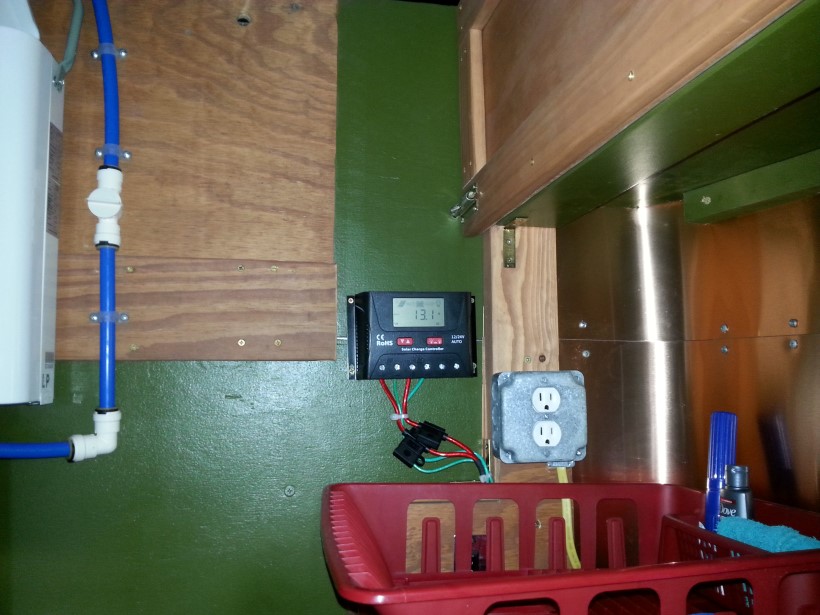

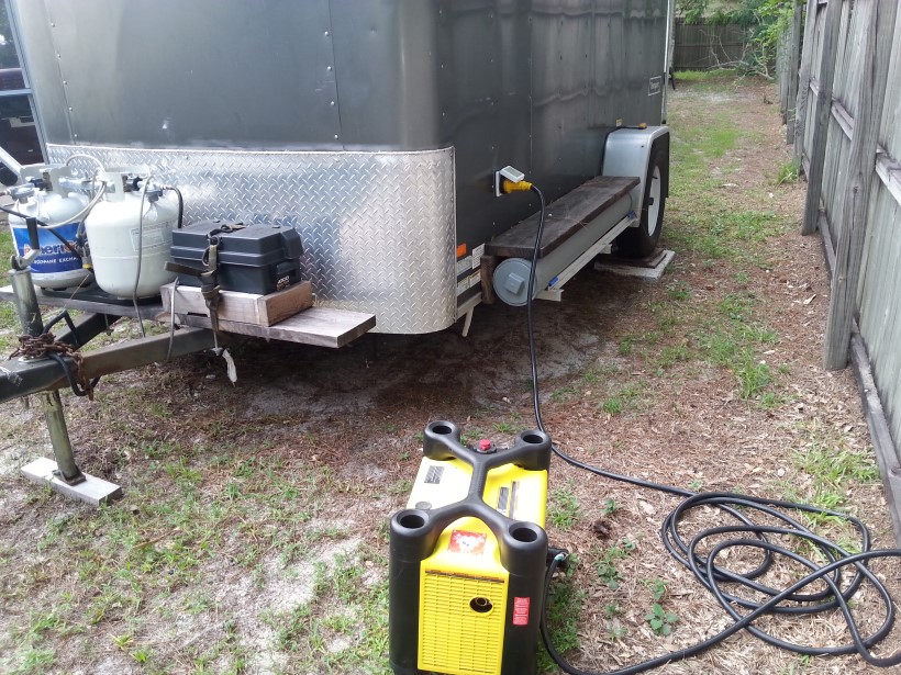

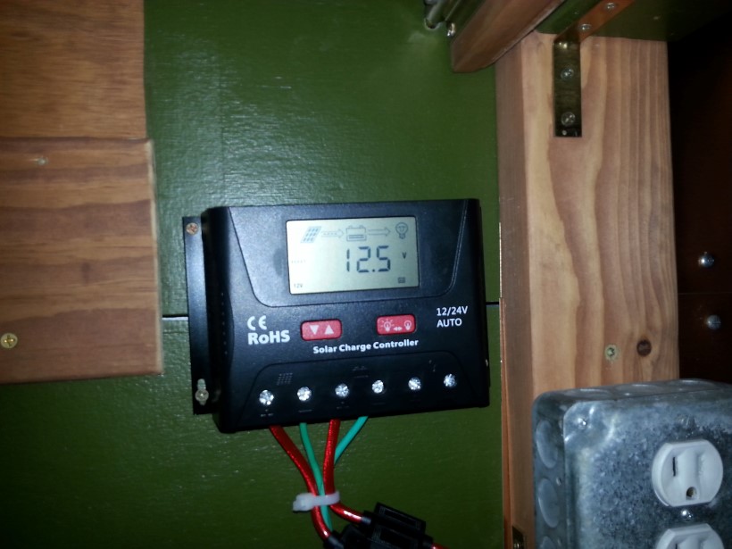

So it is 6 pm. Compare yesterday with to day.
Stuck at 12.5 volts. Cooler 31-35 f always.
But its partly cloudy this afternoon. Battery % fluctuates between 54 and 74 Or there about.
Almost better than yesterday but than bam, clouds.
I don't want to wait this out for a few volts and be bad in the AM. So I hooked up the Champion because that's old gas from our last trip and I needed to run it.
Meter read 100% in 20 minutes now @13.1
my two cents? Just like you said Don. Break even on good sun. Throw in clouds and :thinking: Yes the max fan ran but made a .10 diff.
IDK? :thinking:
But I like it! :thumbsup:

Those bank SoC percentages aren't at all accurate, I'd ignore that completely and either use a SmartGauge or worst case hydrometer SG.
Voltmeter accuracy is not as important since volts don't tell you much anyway, but it would be good to sort that out as well, calibrate against a known-good DMM.
