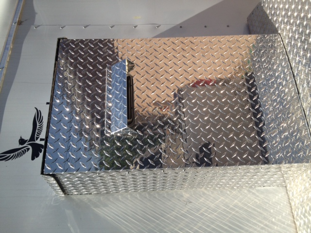

WH vent.JPG (148.98 KiB) Viewed 4523 times
I have no idea why this stupid thing turns everything 90 deg sideways ?? :x :x
pss't don't tell its a little crocket :cry: I'll make it bigger latter with new grinding wheel.
On the front one can see the new 2" x 8" vent, as more water is being used
the harder the air actually blows from the vent, its more like a blower,
the air from the heater is not very hot
I will still install a water tight diamond cover over the exterior vent
to make it blend in a little better. Then when parked the little flap can be lifted up.
After some more testing I was able to mix the water to a lower temperature
so the low flow I would guess at around 1/2 GPM does work on this unit.

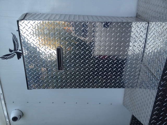

I made a quick rain vent cover , so the rain cant get into the blower ....
The more water I use , the faster the blower blows out the hot air....
when its cold out....it really looks cool :lol:

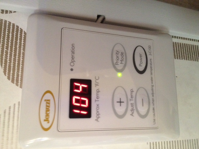

Here is controller in standby

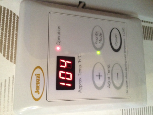

Here is controller red light water flowing & burner is on :D :D

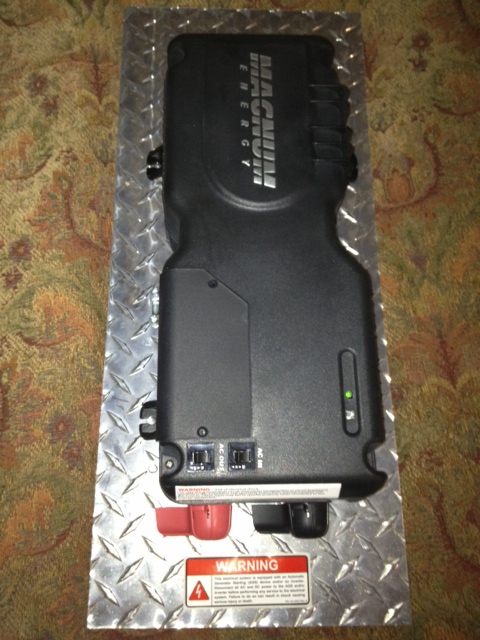

I need to mount the inverter somewhere ...NO room inside cabinets.... :-(( so here is my best idea :poop: ...to keep wiring runs short as possible
Feel free to comment if something better comes to mind ?
Damn sideways photos are a curse :hammerhead:
I turned the pictures on my computer & that finally worked
b MM1512.JPG (109.29 KiB) Viewed 4400 times

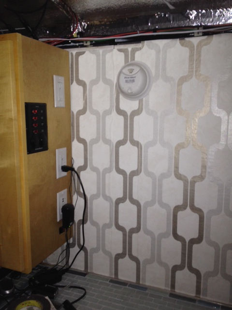

This is the electric cabinet with all the solar wiring inside
a MM1512.JPG (147.4 KiB) Viewed 4400 times
Here is the 6" x 12" inverter on a scrap diamond plate to get the idea across
A friend said to paint the inverter Gold to match the wall paper ? :picklejuice:
