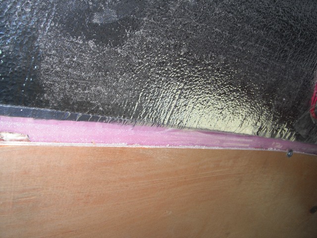

Another detail that I haven't mentioned yet. My ceiling cavities are about 1.3 inches deep. I had already put 1" insulation in and added another 1/2" on top of that. That brought my insulation to where it was just higher than the ribs. On the ribs I placed strips of "sill plate sealer" This is a thin ribbed foam, that is slightly corrugated. The nice thing about it is that it doesn't crush too easily. We already had part of a roll.
I simply cut a piece to length and then split it into about thirds and taped it into place. R value probably isn't much, but a small gap over the metal cuts down on conduction there. It also provided the fill I needed so that my paneling would stay relatively flat when screwed in.
I only took one picture that came out where you can see it.
The panels that I put up on my ceiling are the 1/4" underlayment plywood that both HD and Lowes carries. The corner of one piece that started to delaminate a little. I just glued and clamped it. So far it is holding. I have heard of this stuff delaminating when you use a solvent based finish, but I didn't. I used a water-cleanup polyurathane, and it still delaminated on that one corner. They must use really bad glue!
I still need to replace a small ceiling piece that I don't like the color on, and then put some edge and seam molding up. Then I will take some pictures of the finished ceiling.

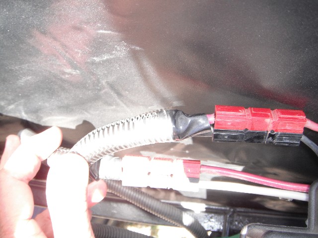

I love Anderson Pole Connectors. They are great. If you aren't connecting your wires directly to a block and need a plug in, then these are the ticket. They are easy to crimp on and you can build a block of connections if you want. The connectors lock together to create a plug of two or more wires. I have these on my battery as I also use the same battery for a boat motor and a fish finder. I also have a portable solar panel that I hook up. It makes an easy switch over.
They come in several different amp sizes and in multi-packs. Here are some reviews on Amazon. http://www.amazon.com/Anderson-Powerpol ... power+pole
And a Youtube on how to install them and snap them together. https://www.youtube.com/watch?v=QzLvdR6X81k

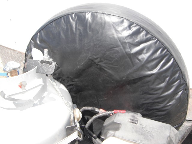

The Bully CM-02 Spare tire cover came. It seems to be a good generic spare cover. In this picture I have it a little loose as I was still lacing a cable lock through the cord lock area on the cover. It does pull much tighter. I wasn't really trying to get a good final picture of the cover. I was trying to do a picture of the Anderson plugs before I tucked them in under the battery cover. :R

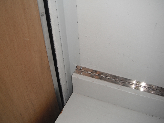

The gap in the corner by my backdoor where the plywood ends has been a problem area for me. I plan on using wood trim on most of my seams, but this gap is an inch wide, and it is also where my bed folds up against the wall. The thickness of a wood trim would interfere with my bed frame fitting flush to the wall. This gap area also is against the small removable panel that is necessary for replacing bulbs in the tail lights. Unfortunately that gap is also a source of fine road dust. The area needed to be sealed, but not permanently.
I finally hit on a solution....roofing drip edge. http://www.homedepot.com/p/Construction ... 093168-_-N
The small lip on this product is not a problem. The only thing I needed to do was to open the angle a little on the piece before I installed it. By open the angle I mean that the molding is set at a little less than a 90 degree angle and you need to widen it a little for it to sit tight against both sides. It was really easy to do. I layed it on its spine on the flat floor and just by pushing it with my hand in the v every 6 inches or so up it, I got a good fit. The resized pictures on here show a kind of ziggy line on the edge that isn't really there.
For the dust, I taped the gap shut before I put the trim piece up. It isn't as good as sealant, but it is more easily removable for when I need to get in this area.

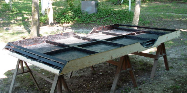

Nobody wrote:There probably as many answers to your question as there are builders on this forum. None are 'wrong' or incorrect. What's right for one person may not work as well for another.

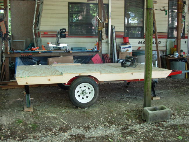

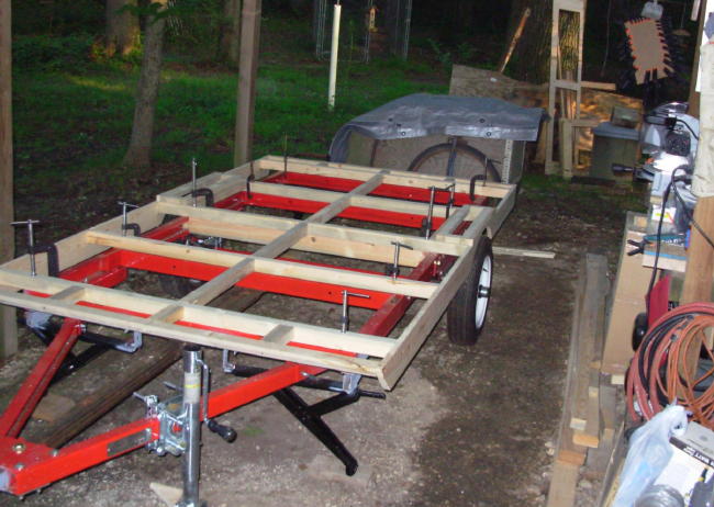

I built my TD in 2006, using an HF 1800# trailer & a couple of profile drawings I expanded from quarter inch graph paper. I built my floor from ripped spruce 2x4's, 1x6 pine for side rails, & 1/2" CDX ply for the decking. After the 'floor' was completed I inverted it on a couple of sawhorses & 'painted' it with asphalt roofing compound. Contrary to conventional wisdom, the coating wasn't nearly as 'stinky' as expected, & the 'tackiness' only lasted as long as it took to dry (overnight). I then cut pieces of 1" styrofoam (Dow 'blueboard') to fit the recesses under the floor, installed them with PL Adhesive, & as an extra caution, I used small pieces of scrap wood as 'battens', 'nailed' to the floor frame with 18ga brads from my HF nailer/stapler. Almost 8yrs & 20K plus miles later (towed thru all kinds of terrain from freeway to National Forest/BLM back country roads/trails) the foam shows considerable stains/marks of travel, a few tiny 'gouges' probably from road debris, but NO deterioration or tendency to 'de-laminate' from the floor. In SE New Mexico in 2010 we encountered standing water in the streets of several towns, that in places almost 'floated' the TD. I've also driven through lots of heavy rain/T'Storms where I'm sure the tires & passing vehicles sprayed lots of water up under the TD. I've found no indication of residual moisture nor any evidence of rot in the wood portion of the floor, nor corrosion to the metal of the trailer chassis. As an aside, I live in central Arkansas where our average humidity is quite high & equipment not properly protected has ample opportunity to suffer ill effects from it...
Here's a few pix of my floor under construction
This how the underside looks this morning (not bad considering what it's been exposed to since 9/2006)
I think we have been over thinking and over engineering floor insulation. I don't regret covering my insulation with the canvas/paint coat, but after having seen how my uncovered insulation is holding up and how little "wear" others have experienced, I think it will be more than adequate for the long haul. I am wondering if the "cover the insulation" comes from RVs and trailer houses originally using fiberglass batts that needed protection from water etc?????
I will continue to check on mine on how it is doing, but I won't be canvasing over the small odd shaped pieces of exposed foam that are in the front. I will be doing some foam fill in spots that I haven't gotten to yet, but that is about it.
In short, if I was to do it again I would glue and screw the insulation on, or batten it, but I wouldn't worry about putting a cover over it. You could always do that later on if you wanted.
