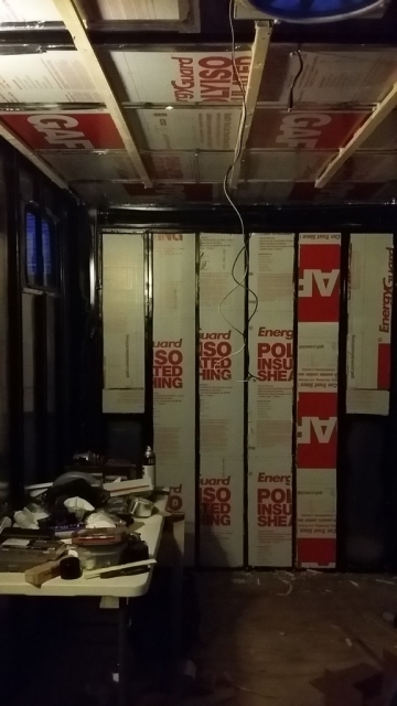

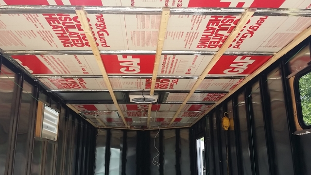

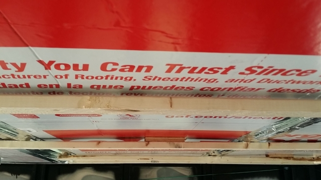

Got the 1st layer in and the furring strips up. Almost ready to install the second layer. I need to run back to Home Depot to get some more supplies. I also need to install that last roof vent for the AC, so I can close up that one spot you can see not insulated yet.
The furring strips along the edges I set off the wall be about 1/2 ". This will make a good wire run to stuff all the wires and home run them to the panel. There are also two channels I have across the ceiling to get them from one side to the other. Once I get all the insulation in, I will be running wires everywhere. :-) I have made a list of all the ones I need.. but I just know I will forget something, so I will leave a few extras in the walls. :thumbsup:
The 1/2 plywood strip I put under the furring strips will ensure a gap between the first layer and second layer of insulation which should improve even better than the R10 with the two R5 layers. There should be no thermal bypass on the first layer which I have completely sealed with Aluminum tape.

Since you are going to have an air space, would it be advantageous to use a foil backed insulation on the next layer? (facing up)

The insulation I am using does have foil on one side (facing up). I am not sure if the small gap will do any good or not since it is not a vacuum like between two pieces of glass in double pained window... but I guess it can't hurt in any case.

I really like the way you are doing the "double" insulation with furring strips and the plywood spacers. Can you say how you fastened the furring strips and spacers to the framing - sheet metal screws?

Also, the furring strips are held with some self tapping finer thread metal screws. They are special in that they drill the wood without threading it so the screw can spin freely to tap the metal. You could do the same by pre-drilling the strips... but this saves time. I got them at Home Depot. Let me know if you want to know the details and I will send the UPC code. They work great.

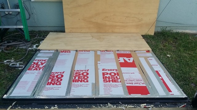

Spent a few hours this evening working on the ramp door. Mostly done. I went with R10 (2 layers) in the door since there was a 1.5 inch gap to fill. This trailer will be well insulated.

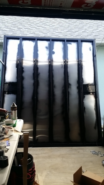

Removed the 1" plywood on the ramp and painted all the metal with Rustoleum Rust Stop.
Installed most of the insulation. I am using two layers . 1.5 " total foam for R10 in the ramp. I'll finish the remainder in the evening this week. I just need to add a few pieces, tape it all up and re-install the wood.

Got the ramp door insulation finished tonight. It is 1.5" deep in the door. Getting ready to make a lot of progress next week. I have 10 days in a row off from work and I am going to spend most of my time chipping away at this build. :thumbsup:
