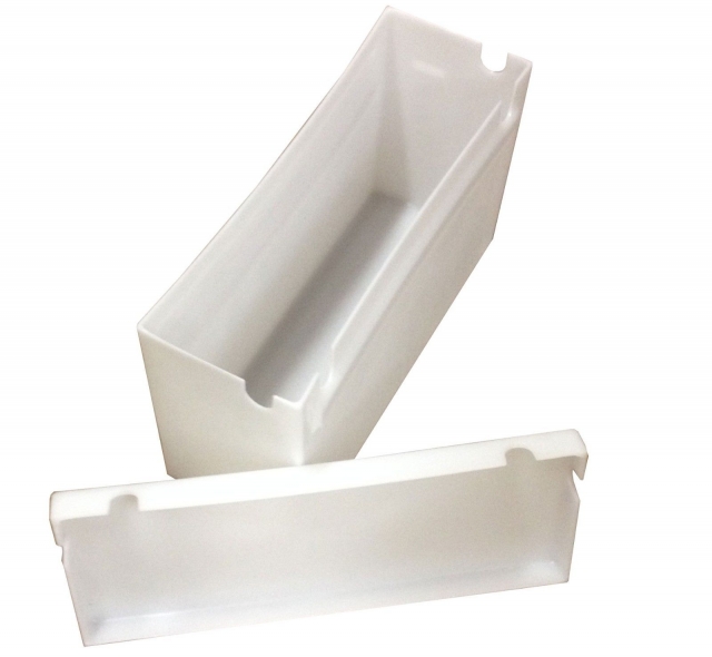

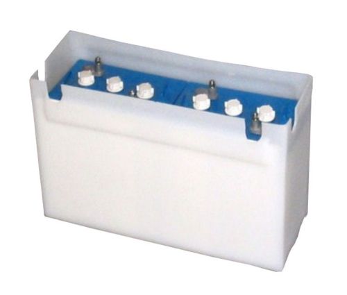

Speaking of battery boxes, I did score one of these nice units.
http://www.ebay.com/itm/Dual-6-Volt-Gol ... SwU9xUSAjr
