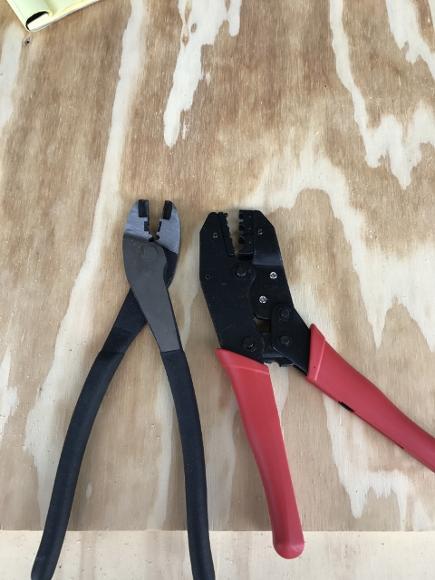

I bought these two crimpers from Harbor Freight.
The ratcheting pair, on the right, with the red handles is worse than worthless. The crimpers bottomed out long before the terminal was sufficiently tight. On some 12 AWG wire, the terminals pulled off with only about 30 lb. of pull … which is dangerously weak. To my pleasant surprise, Harbor Freight refunded my money with no receipt.
The manual pair, on the left, with the black handles, worked great. Very happy with the results.
HF Crimpers.jpg (184.33 KiB) Viewed 4998 times
