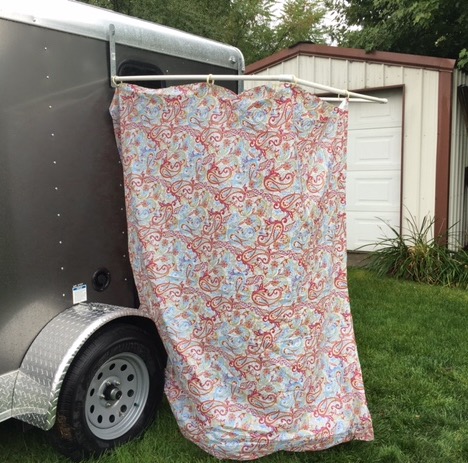

hankaye wrote:fourbtgait, Howdy'
lookin' to build an outdoor shower/throne room???
Easy u-n-down privacy curtain rod do-thingy...
hank
Well that was quick hankaye.
Shower room for wife.
Toilet goes farther away or at the upscale forest service there might be a pit toilet.
Need to adjust it a bit to take the sag out. I was working between rain showers.
fourbtgait

Postby featherliteCT1 » Wed Sep 20, 2017 5:34 am
That shower curtain looks fine.

Postby hankaye » Wed Sep 20, 2017 8:12 am
fourbtgait, Howdy;
Seen a few of those on here, Looks good, think Momma will be happy?
hank

Postby fourbtgait » Wed Sep 20, 2017 2:47 pm
Yes, momma is happy.
But thats the type shower curtain you get for a $1. Oh so thin also

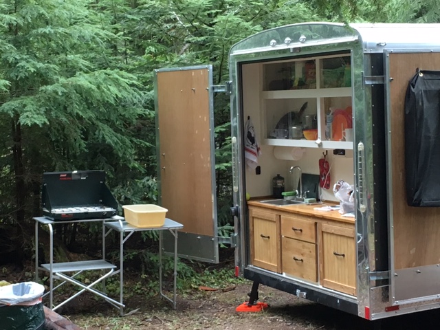

Postby flboy » Wed Sep 20, 2017 7:46 pm
Wow.. Your camper is coming along great. I really like the rear kitchen and outdoor shower. Good idea on the brakes also. They really do take a lot of burden off the TV and if any fishtailing is going on, a slight tap of the brakes brings the trailer back in line. :thumbsup: :thumbsup:

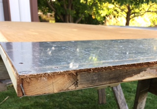

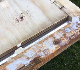

Postby fourbtgait » Fri Oct 06, 2017 6:46 pm
OUCH
Though I bought the trailer new in July, the bottom edges of the doors are wet and moldy. No rot, caught it in time.
But manufacturing date of trailer was last spring.
So I would suggest even if yours is new, to check it out.
I would hate to see a used one.
fourbtgait
Posts: 207
Images: 16
Joined: Tue Dec 02, 2014 4:17 pm

Re: 6x12 build
Postby Rainier70 » Sun Oct 08, 2017 8:10 pm
I am curious on how water got into your door?
Rainier70
Posts: 1083
Images: 244
Location: Southeast Idaho
Re: 6x12 build

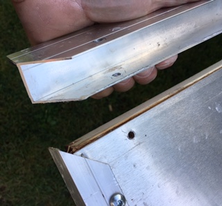

Postby fourbtgait » Mon Oct 09, 2017 2:06 pm
Rainier70 wrote:I am curious on how water got into your door?
I was also.
Carefully inspected all aspects, holes.
None showed water stains of any kind.
Ive decided that the water came from within. Not fully dried lumber when built. The heat of summer produced condensation thant ran down the metal to the bottom of the framing. No way out. The metal kick plate may have not allowed it to travel thru the inner skin. There was mold under one of the kick plates.
So I have thought of drilling 4 holes, 2 high, 2 low. Even thought I insulated the door, there is more backing material than insulation. The holes should provide some airflow if any moisture still exists inside.
fourbtgait
Posts: 207
Images: 16
Re: 6x12 build
Postby Rainier70 » Mon Oct 09, 2017 4:57 pm
The airflow holes, or at least drain holes, sound like a good idea.
I am definitely thinking about checking mine. I don't have time to take it the door apart right now, but I think that I will drill a couple of small holes in the bottom and see if I can probe the wood a bit.
