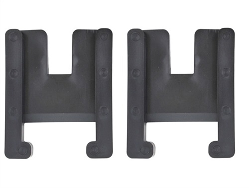

Anderson WD and Anti-Sway Hitch.jpg (26.84 KiB) Viewed 3913 times

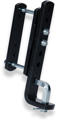

I used to have a wd/as hitch one of the main brands (Equal-i-zer),Metal bars riding on Large 'L'
brackets, removed the noise by using a drop of liquid soap (Dawn in my case), as a lubricant.
Beauty is, after the first few movements they are naturally quiet and when you rinse the bars
and other attaching parts off with a hose, they are nice and clean not messy like when ya use
a grease or oil.

I did find a "solution" to the noise problem I think... it's a "sway bracket jacket"!
https://www.equalizerhitch.com/manuals- ... et-jackets
I think I've narrowed down the choices now...
Sway Bracket Jacket.jpg (24.98 KiB) Viewed 3870 times

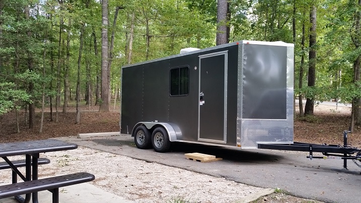

Well the trailer is still far from being finished, but it was complete enough for us to take a brief camping excursion...
There were all sorts of unforeseen difficulties we had even before we left the driveway and we were beginning to wonder if we needed to postpone the trip to a later date to get better prepared. But reasoning that there will never be a time when everything goes perfect, we went ahead and left about nine hours later than we expected to. I'll spare the boring, mundane and pathetic details for this post, but I felt like someone might wonder why there were no photos around the camp-fire, inside the trailer or any leisure time. I was at an RV parts store getting a new vent installed for the roof...
Destination: Crater of Diamonds State Park (Murfreesboro, Arkansas)
Both my wife and my mother dug and searched and dug and searched for diamonds recently at the Crater of Diamonds State Park but came up empty handed. The park had been reporting several good and promising reports this months regarding finds, but most were discovered after a decent rain. It was dry when my wife and mother attended.
The camp ground and site(s) were very nice with a pleasant "wall of woods" that separated you from the other campers offering a little privacy. Diamond hunting isn't something I would care to do very often because the quality of diamonds themselves are not very valuable but it makes for a fun trip to do something different, besides my wife and my mother wanted to go... so that is reason enough and they both had fun even without finding the mother-load!

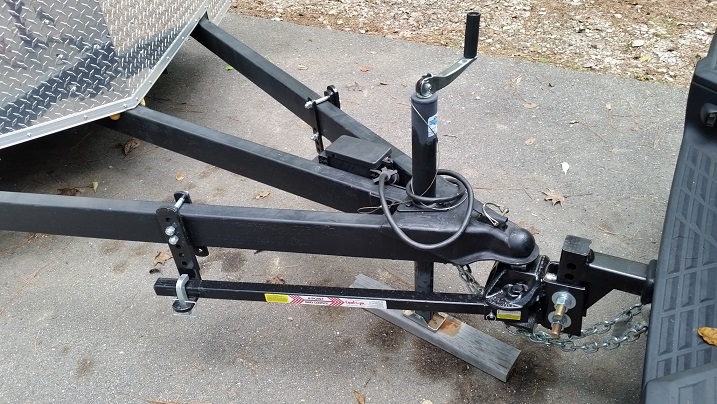

The Equalizer Weight Distribution & Anti-Sway Hitch:
The hitch was money well spent. I couldn't believe how smooth and straight the trailer towed.

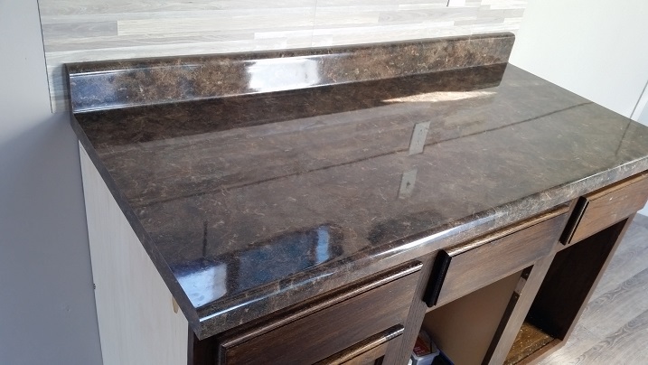

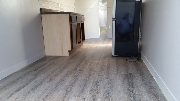

Inside the trailer:
The photos below do not reveal it, but the now have curtains. The counter top is attached and the counter itself is attached to the wall. The unstained sides of the cabinets are there because there will be a short wall covering up that section. The cabinets now have the doors installed and look nice even though we need to install the handles. The Fridge has been secured to the floor for traveling. On this trip we used some nice cots with foam cushions. Beds will be installed soon.
Weight Distribution & Anti-Sway Hitch.jpg (168.31 KiB) Viewed 3648 times

We didn't even use the stabilizer hitches, nor did we un-hitch the truck from the trailer...
COD Campsite 1.jpg (176.03 KiB) Viewed 3647 times

I can see the WD part of the hitch, but how does the antisway function work? I am use to a different configuration with friction plates.

Anti-Sway
Equal-i-zer calls it their 4 Point Sway Control. Four Point Friction Control is what I would call it. Two places on the Hitch itself where the arms attach and the two brackets where the Weight Distribution Arms are attached are the other two Friction points. Here is a video that explains it a little better than I can:
https://www.equalizerhitch.com/how-equalizer-works
