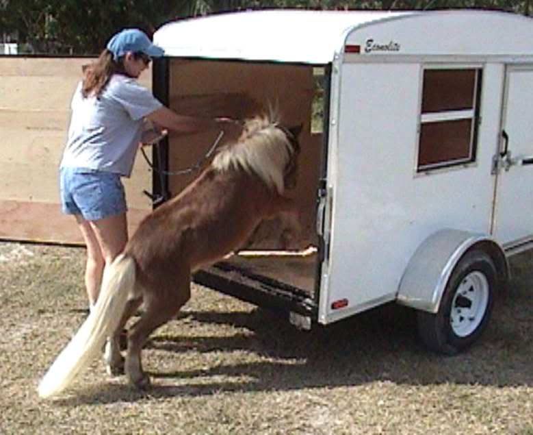

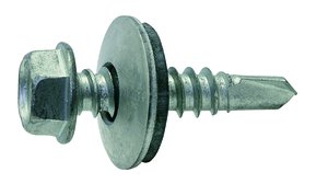

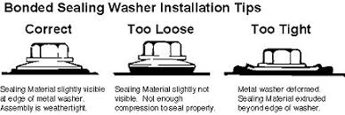

A 12 ft. FEATHERLITE conversion
Re: A 12 ft. FEATHERLITE conversion
Postby OverTheTopCargoTrailer » Sun Jan 12, 2014 6:12 pm
Prem wrote::o Toy hauler with gasoline inside trailer. :NC
PREM ......NO MORE FIRES !!!
You JINX ME .... I had a flood , when plastic cover to 1/2 water filter broke
OverTheTopCargoTrailer
Posts: 1628
Re: A 12 ft. FEATHERLITE conversion
Postby Prem » Sun Jan 12, 2014 9:57 pm
Wow Jerry, speaking of water explosions:
:rofl: :rofl2:
My goal...
...is to live in a trailer.
Prem
Posts: 3222
Images: 144
Re: A 12 ft. FEATHERLITE conversion
Postby Prem » Mon Jan 13, 2014 12:02 pm
:thinking: Inmate trailer?
:NC What? DARN. Look what we missed:
My goal...
...is to live in a trailer.
Prem
Posts: 3222
Images: 144
Re: A 12 ft. FEATHERLITE conversion
Postby Prem » Mon Jan 13, 2014 1:12 pm
My goal...
...is to live in a trailer.
Prem
Posts: 3222
Images: 144
Re: A 12 ft. FEATHERLITE conversion
Postby Prem » Mon Jan 13, 2014 4:39 pm
8) Every now and then someone builds a good one of these:
:shock: Miniature horse trailer
My goal...
...is to live in a trailer.
Prem
Posts: 3222
Images: 144
Re: A 12 ft. FEATHERLITE conversion
Postby Prem » Mon Jan 13, 2014 8:23 pm
Electronics Lab
My goal...
...is to live in a trailer.
Prem
Posts: 3222
Images: 144
Re: A 12 ft. FEATHERLITE conversion
Postby Prem » Mon Jan 13, 2014 9:01 pm
:) Himalayan interior motif
My goal...
...is to live in a trailer.
Prem
Posts: 3222
Images: 144
Re: A 12 ft. FEATHERLITE conversion
Postby Prem » Mon Jan 13, 2014 10:15 pm
Directly paintable, no filling or sanding required. Good for interior or exterior. Commonly comes in 3/8", 1/2", 5/8", 3/4", 1-side or 2-side Kraft paper covered. :thumbsup:
My goal...
...is to live in a trailer.
Prem
Posts: 3222
Images: 144
Re: A 12 ft. FEATHERLITE conversion
Postby Prem » Mon Jan 13, 2014 11:57 pm
:pictures: What I use whenever I have to put screws into the sheet metal exterior of my trailers. (Like for mounting vents, hose connections, cover plates, et al.) You can first screw them into a cardboard box and spray paint them whatever color needed to match your sheet metal.
#10 stainless steel hex-head screws (whatever length needed) with stainless steel neoprene cup washers:
Self-tapping (not my favorite due to slightly looser fit):
Correct pressure/tension set by adjusting the torque on your screw gun:
https://encrypted-tbn3.gstatic.com/images?q=tbn:ANd9GcRJvcui3hboDFAlNHQYp480dD0l-GXygvAXBFzzyLb0Gesz_5Oy
The painted/electro-plated zinc version of these are okay, but I just don't like corrosion and rust, so I only use SS. :beer:
My goal...
...is to live in a trailer.
Prem
Posts: 3222
Images: 144
Re: A 12 ft. FEATHERLITE conversion
Postby Prem » Tue Jan 14, 2014 3:22 am
My goal...
...is to live in a trailer.
Prem
Posts: 3222
Images: 144
Re: A 12 ft. FEATHERLITE conversion
Postby OverTheTopCargoTrailer » Tue Jan 14, 2014 11:15 am
Prem wrote:
:NC What? DARN. Look what we missed:
This is like 10,000% TOTAL BS , it's mostly a dead site , they offer a $1,000 prize
Which really was a 1 year website , don't waste your time here !!
OverTheTopCargoTrailer
Posts: 1628
Re: A 12 ft. FEATHERLITE conversion
Postby Prem » Tue Jan 14, 2014 12:10 pm
My goal...
...is to live in a trailer.
Prem
Posts: 3222
Images: 144
Re: A 12 ft. FEATHERLITE conversion
Postby Prem » Tue Jan 14, 2014 2:00 pm
:beer:
My goal...
...is to live in a trailer.
Prem
Posts: 3222
Images: 144
Re: A 12 ft. FEATHERLITE conversion
Postby Prem » Tue Jan 14, 2014 2:10 pm
:wine:
My goal...
...is to live in a trailer.
Prem
Posts: 3222
Images: 144
Re: A 12 ft. FEATHERLITE conversion
Postby lrrowe » Tue Jan 14, 2014 3:14 pm
Prem wrote:
Too big to post as an image:
http://ginnywolf.files.wordpress.com/2013/06/img_6089.jpg
Simple, appears to be organized and looks as if it works for him. That really makes it a great job.
Bob
lrrowe
Posts: 3285
Images: 439
Location: SW Virigina
