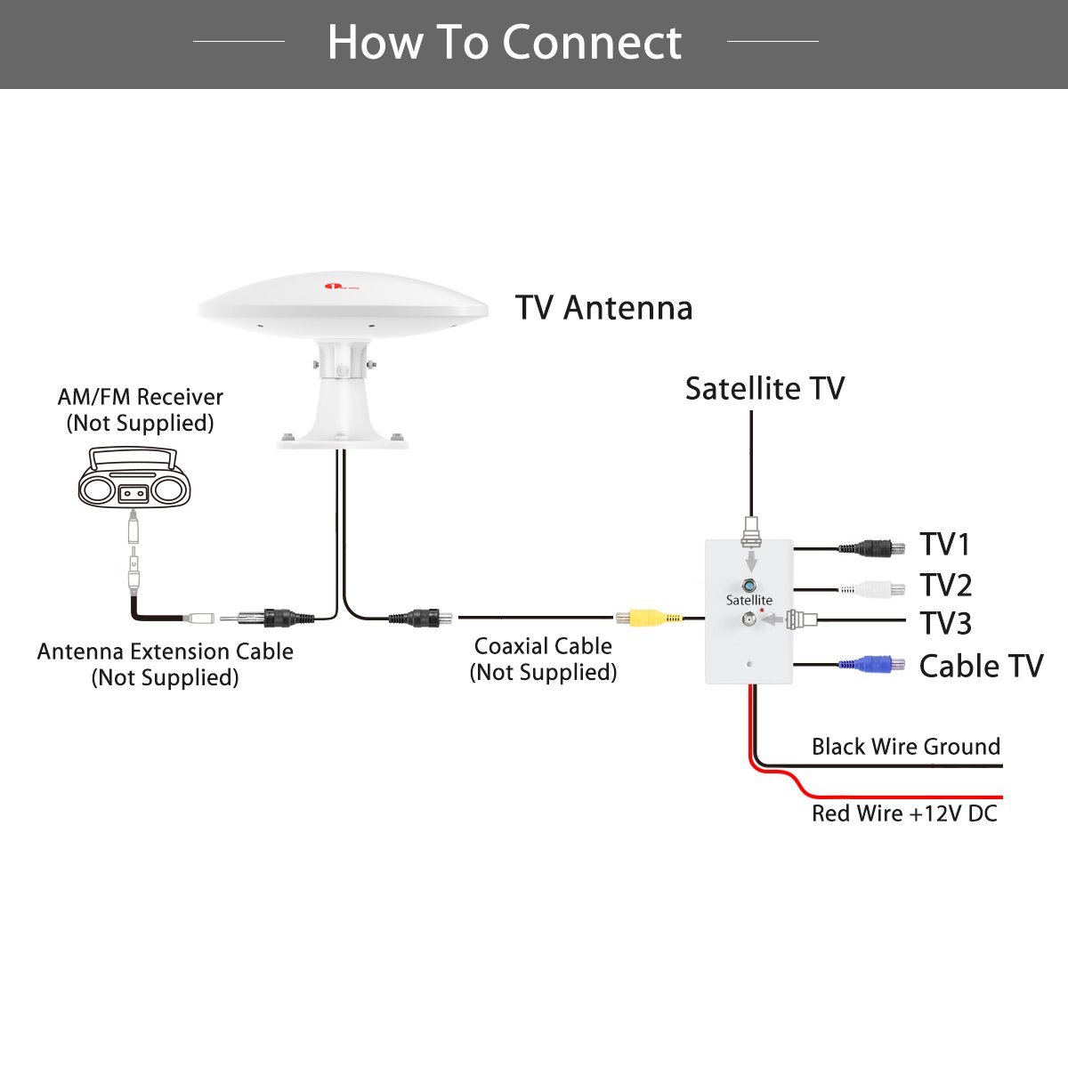

Do you have the preamp Installed and powered? It looks like a wall plate and had a small circuit card on the back side.

flboy wrote:Do you have the preamp Installed and powered? It looks like a wall plate and had a small circuit card on the back side.
:thinking: Will check
Tommy B
Posts: 891
Joined: Sun May 08, 2016 4:37 am
Re: HALLMARK 6X12 CONVERSION
Postby flboy » Wed Aug 23, 2017 7:37 am
That USB connector just provides power. Those antennas are active and require power. USB probably providing 5v. That is why digital only works when that is plugged in.
Did you connect the preamp as I mentioned? That preamp provided the power to the antenna through the same coax on the signal lead. It does not work without it. Youd know if you installed it. The antenna does not go directly to the TV, it goes through the preamp wall plate which must also have 12vdc applied for power.
Postby Tommy B » Wed Aug 23, 2017 7:55 am
yes they both still had to hook up the coaxial cable. You are of course right
I did not hook up a pre amp and don't know what it is. The only other hardware provided was the AC adapter. You know small black box like with AC MALE PLUG on one end and small female connector to TV. I did not utilize this yet. Other than that there seemed to be no other connections to be made or plugged in. :thinking:

Postby Tommy B » Wed Aug 23, 2017 9:40 am
Ok I know you are busy @work. Sorry
This is what you mean. I double checked the items that where supposed to be supplied and they all are there. Unless the AC power supply is involved but I don't think so.
It looks like that antenna power supply is provided with the antennas now as in this one.?? I think so. No wonder the price was so good on the TV.
