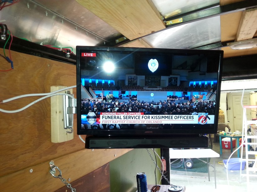

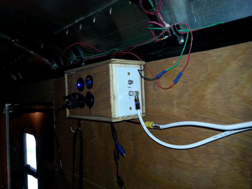

Ok Antenna hooked up now with preamp. I have a few choice names for it but....its in.
62 channels and all I can say is wow, holy chit. Still So glad I put this TV in. Awning led lights are now pre wired at this point. Antenna is just setting on the roof at this time. Not mounted just yet.
Really pleased and shocked at the free TV channels this antenna provides. Don I will even up with you when you get back. :thumbsup:
AWESOME!

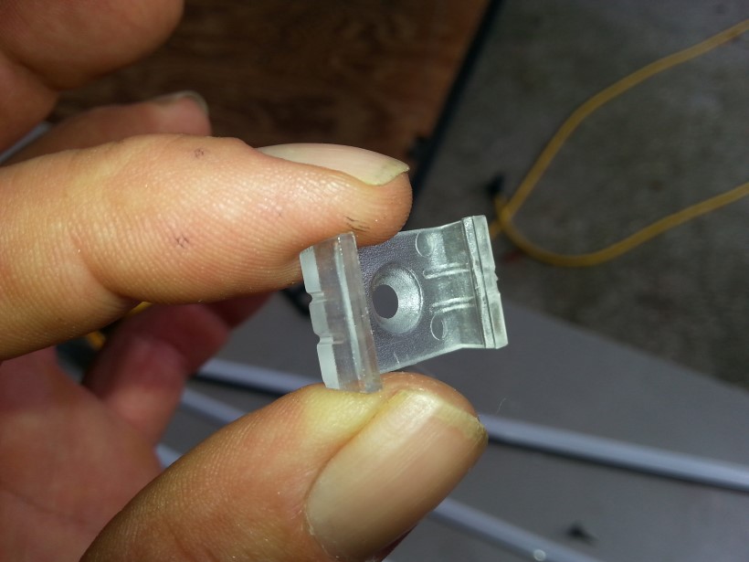

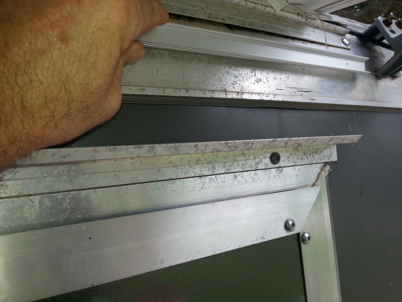

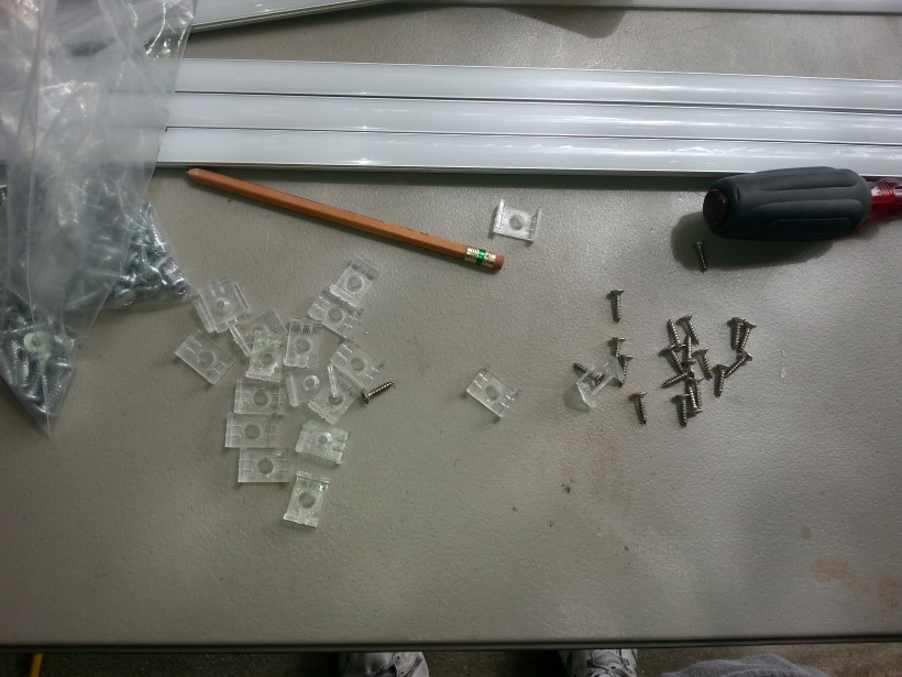

But I do need advice please from anybody. I need to affix these aluminum LED channels to the exterior. They provide plastic clips and wood screws but that wont flush here and I am reluctant to drill 7-9 holes in the roof/side but I will If I have too. Maybe get the same screws in metal self tapping if they make them. BUT...
Would a aluminum liquid nails be better? IDK and really need advice. I am leaning towards liquid nails if it works for aluminum to aluminum.
Thanks.
Those screws in the bag to the left are from haulmark. They are pan head squares and will not work here.

Postby WoodSmith » Thu Aug 24, 2017 2:26 pm
Try good quality 3M Very High Bond (VHB) tape. Home Depot and Lowes carry it around here, but is also on Amazon.
https://www.amazon.com/3m-vhb-tape/s?ie=UTF8&page=1&rh=i%3Aaps%2Ck%3A3m%20vhb%20tape
Be sure to clean the Aluminum first.

Postby Iconfabul8 » Thu Aug 24, 2017 2:29 pm
I think I would try some of that super dooper double stick tape they make now days.

Postby John61CT » Thu Aug 24, 2017 3:37 pm
5952, different widths available
https://www.amazon.com/gp/aw/d/B01BT0A6MG
google for the surface prep protocol for plain metal, and get a good roller to apply pressure

Postby flboy » Thu Aug 24, 2017 4:38 pm
Tommy, the bonding with the really good 2 sided tape along the entire strip as suggested by a few others may be the way to go. The strip is covered by the awning in transit so no windforces or etc.. to stress it out. It has to stick well and not come off easily. You will get a good look at the health of the bond each time you deploy the awning in any case.

Postby Tommy B » Thu Aug 24, 2017 5:31 pm
flboy wrote:Tommy, the bonding with the really good 2 sided tape along the entire strip as suggested by a few others may be the way to go. The strip is covered by the awning in transit so no windforces or etc.. to stress it out. It has to stick well and not come off easily. You will get a good look at the health of the bond each time you deploy the awning in any case.
Yup, that's what I will do. Thanks ALL! Will Report back when done! :thumbsup:

Postby Tommy B » Fri Aug 25, 2017 9:41 am
going to get this stuff per the advice here.
3M Scotch 5952 VHB Tape: 1 in. x 15 ft. (Black) Price: $22.76
Free Shipping for Prime Members
Seems to be the best thing out there.
Thank You John61CT and all who responded. :D
If the weather isn't too bad I will mount the antenna and lights tomorrow. Also need to re due the tension on the awning as well as replace the awning lower brackets as they both are broke. The awning frame is showing its age a little.

Postby John61CT » Fri Aug 25, 2017 10:43 am
don't neglect surface prep, and consider active heati, g
