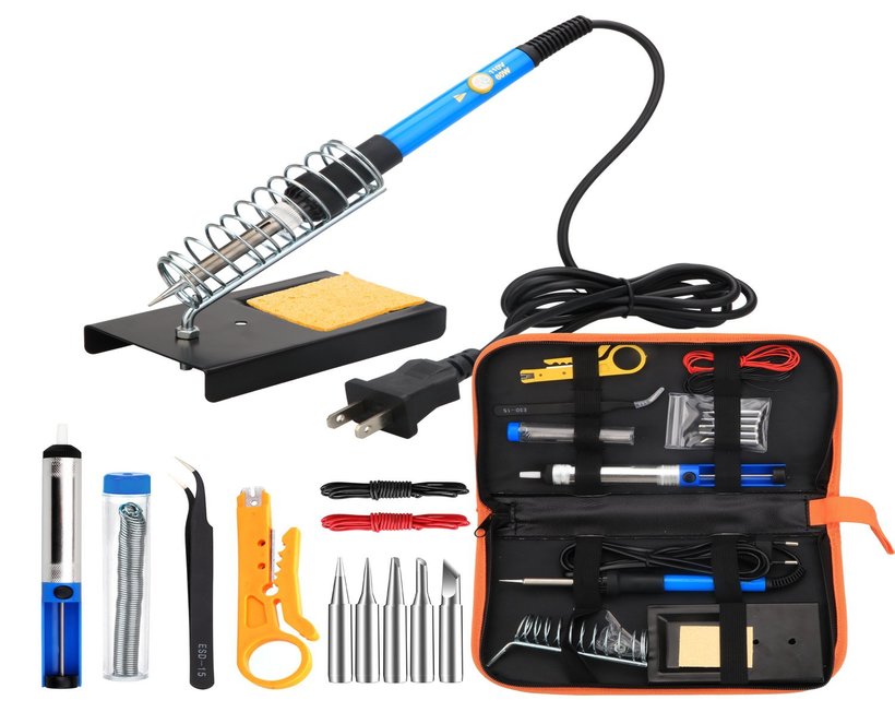

Postby Tommy B » Wed Aug 30, 2017 8:14 am

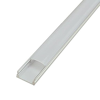

Well the TV antenna is mounted proper. The LED light channel is attached and caulked in tight. Looks good. HOWEVER, the LED lights do not stick at all. I even purchased another brand at expense and they did not stick either. You could see the back of the tape had peeled off some in storage and it dried out in the box on both sets. :x
I am having to order more double sided sticky tape and will use that stuff to secure the LED lights into the channel as it really works well.
Don I figured it was high time I ordered this iron for $17.00 and that will set you free my friend! :D

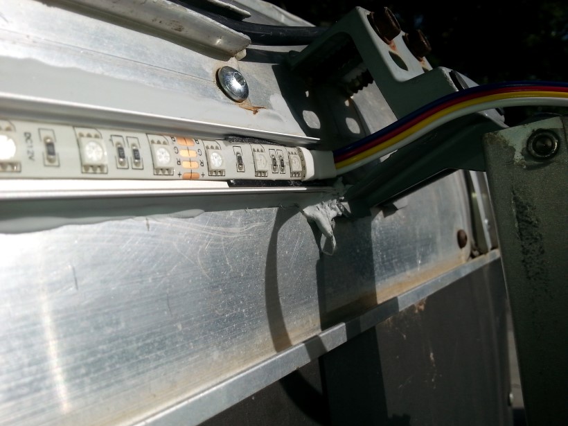

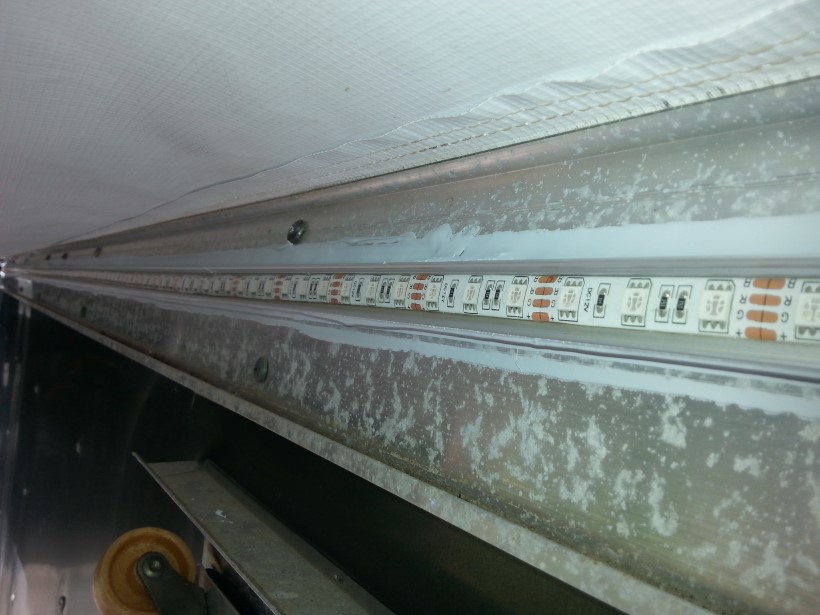

Postby Tommy B » Wed Aug 30, 2017 4:31 pm
Don I took another REALLY close look at the tape. Like you said brother! My, eyes, my knees, my......anyway, thank you for the input. We have LED lights!
Wait for dark to see!
I beefed up the forward end with that really good tape as you can see. I also have opaque covers but we will see how it looks with and with out them.
Now I have that other cheap set to put in the trailer. These cost $95.00 but they are noticeably beefy and bigger than the $18.00 ones and they came with a 12v cigarette lighter plug in plus a really good wireless remote with antenna. It really works from a distance. :thumbsup:
That caulking is non- self leveling LAP sealant. I did not even know it existed. Learning so much every day now.

Nice work Tommy!

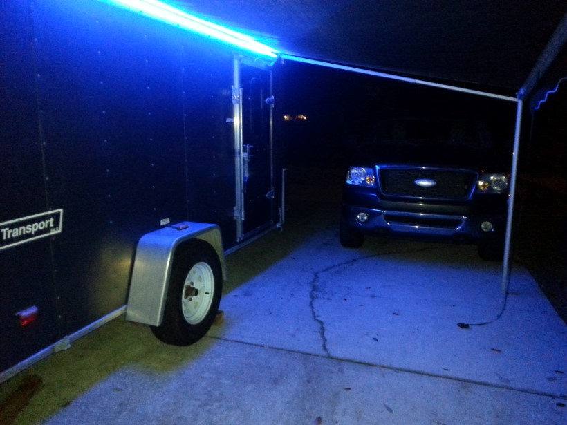

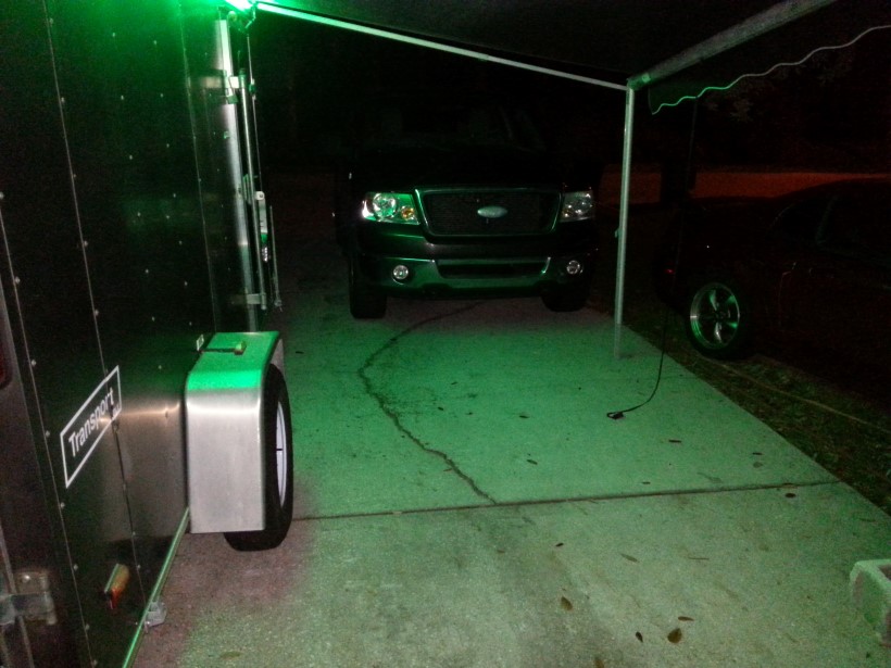

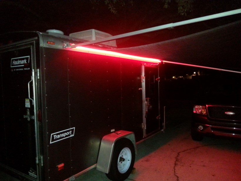

Postby Tommy B » Wed Aug 30, 2017 7:18 pm
Padilen, get them back! :D
This is with the opaque covers and I will leave them on. Oh yes they JAZZ and mix or static. 5 or 6 six colors. :thumbsup: :thumbsup: :thumbsup: :beer: :beer: :? :D 8)

Postby McDave » Thu Aug 31, 2017 4:04 pm
Tommy B wrote:Don I figured it was high time I ordered this iron for $17.00 and that will set you free my friend! :D
:applause: That aboy! That's a damn nice set for 17.00. A good soldering iron and a VOM are really the basics and should be part of every toolbox. Spend a little time on the net to learn what makes a good, reliable solder joint. Once you have that skill down, you will never have to worry about yourconnections failing. Bad connections are the most common failure and cause of damage. In the future you may find a need for a soldering gun, or butane pencil torch. Those are mainly for people who do a lot of field repairs, but they come in handy.
Just remember that with soldering cleanliness is next to godliness. Oxidation is a killer. Keep that tip tinned at all times. Solder is an electrical component ONLY. It is NOT a mechanical attachment or weld. If you need strain relief to protect the connection use a mechanical method. (screws, clamps, ties, shrink tube, epoxy, etc.) Clean the flux left behind, as it is still a corrosive. Less is more, you should be able to see the contours of the wire in the solder and it should have a bright, shiny, metallic luster. "Bridge" soldering is probably the easiest and most effective. Prepare the wires to be soldered, clean and twisted tight, then put a healthy drop of solder on the iron tip. Use that drop to form a heat bridge to the connection, then feed solder as needed. Heat it, feed it, get off. The heat can do damage as well. A little practice and you'll get the timing down.
Another feather in your cap. Good Luck.
