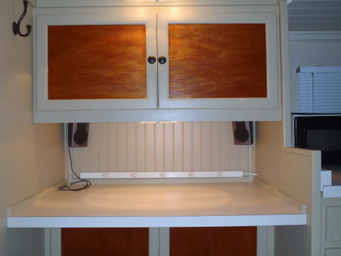

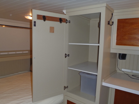

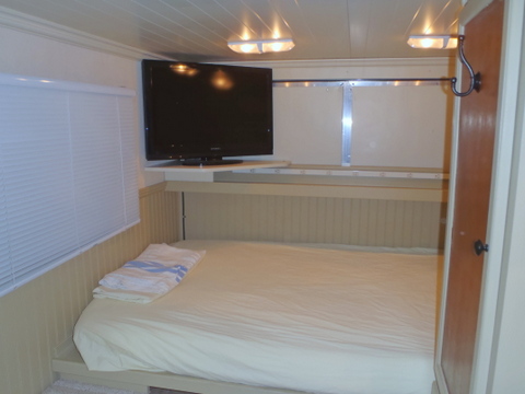

Here are the last few photos. I added the shelf for the TV and made a "headboard" for the bed with storage behind it. The tall closet that was originally for hanging clothes has had the hanger rod removed and a couple of shelves. Those shelves are just laid in place on runners and can be lifted out it something changes.
I mounted the laptop speakers above the desk, and installed a few hanging hooks and a towel rack under the sink.

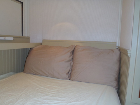

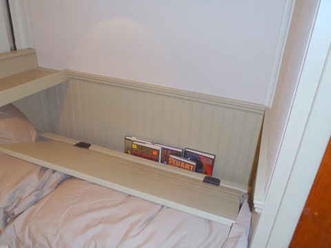

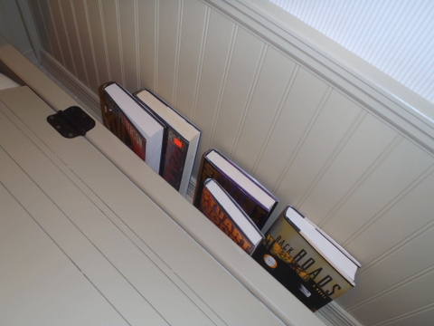

Here is the storage headboard. The slanted headboard is hinged at the bottom and hinges forward to access a storage area 5 inches wide, 6 inches deep and 48 inches long. It is a great place for books

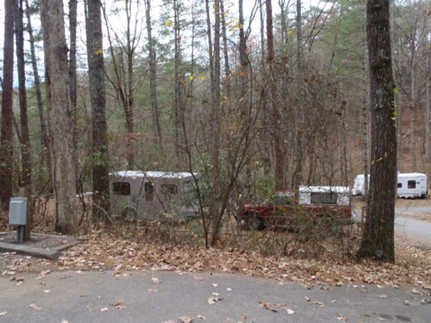

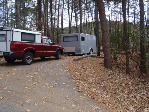

We went on a trip thanksgiving week for 8 days. The weather was clear and, for this Florida boy, it was cold. It got down to the 40's at night. I was pleasantly surprised at the performance of the $20.00 ceramic heater I had previously bought from Walmart.
I was hoping that the little heater would take the chill the inside. But the little heater kept us toasty warm and very comfortable. The heater's thermostat cycled on and off.
One tip when making advance reservations for a camp site. When asked how long your rig is exaggerate, a lot. Obviously the bigger rigs get bigger and flatter spots. I got put into a very tight spot at Unicoi State park in Georgia. The site was on the site of a steep hill that was tough to get into.

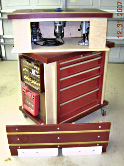

pmspirito wrote:Today we began rough cutting the cabinet pieces.
[img]89093[/img]
This router table s used to cut the profile for the inside edge of the door panels and to cut the groove that will hold the center panel in place.
[img]89094[/img]
I know this is from a photo you posted last year, but... WOW! what a router table. Did you build it? Plans available?

I made the router table. Here is a link to my web site http://peterspirito.com/routertable.htm for the whole story on the router. This photo also shows how it comes apart quickly to allow the table to be transported to a job site and the roller base to be used for other things. You may need to scroll down the photo.
