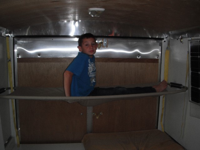

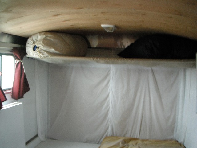

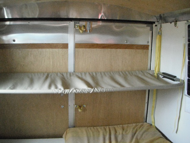

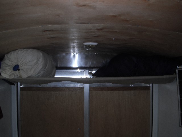

I replaced the cargo net I was using for my sleeping bag and pillows with a bunk/storage shelf made from 3/4 in electrical conduit. It is holding up well so far, but I probably should have used 1in conduit to make it a bit stronger as a bunk.
I already had the d ring hangers up on the top of some of my ribs to tie off the cargo net and for other uses. Once I put the bunk together and sewed a cover for it, all I needed to do was add the straps to the corners to raise and lower it.
This first picture is a poor picture of one of my grandsons, but was the only one where the flash worked and isn't blury.
This one is with the bunk pulled up and loaded with sleeping bags and pillows for traveling.
I added this picture to show the dust curtain that I put up for traveling on gravel roads. It catches the dust and dirt that collects on top of the rear door seals and keeps it from coming inside when I open the back doors.

As you can see by the pictures I have posted above, I have finished putting the panels up for my ceiling. I still need to put up some molding yet. That isn't a huge priority,so it will probably wait a while.
I used the 1/4in moisture resistant underlayment plywood from HD. The plywood has two finished sides. One side looks like a Philippian Mahogany and the other is very light in color....almost a birch color. The finish was a water based semi-gloss clear polyurethane. http://www.homedepot.com/p/Unbranded-7- ... /203183010
I have also put aluminum flashing up in my curved side area and both front and back end caps. I used a 25 ft roll of 14 in aluminum flashing. I first cut off the 12 ft for the sides and then cut it in half length-wise. So then I had two pieces of 7in flashing for the sides. I chose to use the wider 14in because I wanted to also use it for the piece above the back door and the area of the front cap. The front cap was tricky and I got a couple of kinks in it where there were double bends. I will have to take some more pictures of the front later. http://www.homedepot.com/p/Construction ... /202092848
