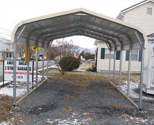

I know how you feel about these but Just for conversation, I really want one. It would really save the trailers life span it would seem. Just curios.
Can you tell me Don, If I did have one of these, would the solar panel put out anything as it is not totally covered. :thinking: Probably not. But you could mount one on top of the car port and wire a quick T disconnect to the one on the trailer? Just to keep the battery charged.
Hey I can see from work via security camera that my awning fabric has arrived at the front door and it appears to be about 10 feet long. I pretty sure I got the metal weather guard. Cant wait to get home. See you around 5.
Just camp fire talk on the carport. Cant afford it now.
