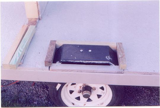

I thought the waiting was going to maim me, if not kill me outright. But my custom-built trailer arrived two days ago. Take a look at the pictures in my album, I'm so psyched!
Some notes on what you'll be seeing --
1. 6'x10' black Pace American CargoSport trailer. It has LED lights all around, a Dexter torsion axle, chopped a foot to fit in my garage leaving an inside height of 4'11", 12V and AC lines, lights, switches and outlets, completely insulated, a window on each side, porch lights, an outside AC outlet, E-Track on both sides and more.
2. The factory missed installing a cable hatch for the AC 30A shoreline, so the dealer will be installing one later. Also, the door holdback latches for the rear doors are installed in the wrong places and one of the over-rear-door LED marker lights popped off and has to be reinstalled.
Does anyone have advice about where the cable hatch should be installed? The factory would have put in a cheap round hatch, but since they goofed I want to take advantage of it and have the dealer install a larger square hatch so I can reach in from the outside and grab the cable.
3. Once we got it home, my wife and I screeted glue mastic all over the floor and laid a speckled dark blue indoor/outdoor carpet. I think it looks great. We have to cut out the D-Rings though.
4. A 5000RBT Fan-tastic Vent with the flat smoke lid (more clearance for the garage door) is on it's way for installation, to replace the factory roof vent.
5. I goofed and didn't allow enough room between the E-Tracks for someone to sleep, so unfortunately my plan for bunk-bed-like platforms is blown. But I think I can stretch 2'x6's across the top E-Track and put a cot underneath.
6. Pace American stuck a half-dozen obnoxious large white stickers advertising themselves all over my black trailer. Looked like hell, so I took a few minutes and pulled them (slowly) all off. Looks much better now.
7. I want to put a caster on the tongue jack so it will be easier to roll into our garage, but the holes for a locking pin don't line up, so now I need to find a local metal shop to drill holes through the caster mount to match.
A lot of work coming between now and first camping trip May 16th. I want to work on front cabinets next.

The trailer is back at the dealer to fix some problems; the rear door holdbacks were put in the wrong location, so they have to be moved/adjusted, some trim is falling off and needs to be secured, the forgotten-to-be-installed cable hatch needs to be installed, the fan-tastic vent is being installed, an LED marker light is being secured, and the tongue jack is getting a wheel to make it easier to move around in our garage.
I'm really stuck on the cable hatch, and could use advice. The shoreline provided by the factory is coiled and hanging from an aluminium bracket mounted on the lower wall near the front street-side of the trailer, alongside the A/C panel. I bought a large rectangular access panel, looks like this:
http://www.campingworld.com/shopping/it ... tches/1856
If anyone has installed something like this in the past, how did you finish out the inside so it didn't look like hell? It's a plastic frame and a hinged door, so once the hole is cut and the hatch is glued in, from the outside it will be fine, but on the inside... there's no garnish, flush plate or trim piece to make it look clean.
Or can you recommend something similar that comes with the interior trim needed? Thanks.

Postby edcasey » Tue Apr 28, 2009 11:40 am
digimark wrote:I'm really stuck on the cable hatch, and could use advice. The shoreline provided by the factory is coiled and hanging from an aluminium bracket mounted on the lower wall near the front street-side of the trailer, alongside the A/C panel. I bought a large rectangular access panel, looks like this:
That is a very common hatch used on campers. They never intended anyone to see the back side of it so there is no trim ring available. I don't know your plans for the interior but could you build a plywood storage compartment inside the camper for the shore cord to be pushed into from the outside like they do on commercial campers? My shore cord originally stored in a compartment under my refrigerator. That was before we changed the inside layout for the 593rd time.

Postby digimark » Tue Apr 28, 2009 12:43 pm
Ed -- thanks for the advice. Since I am building a cabinet to cover it up anyway, the dealer suggested putting the hatch in the floor next to the AC panel. I was worried it would let water in, but she said it wouldn't, so I'm going to try not to over-think this one.
Still got to start working on the front upper and lower cabinets. My Kreg kit and screws came in today - ooh. More on that in a bit.
