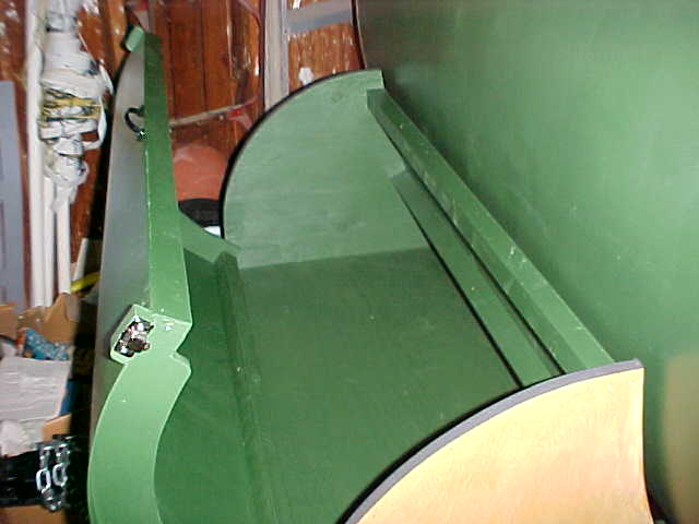

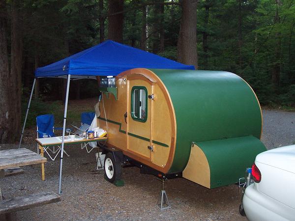

Sam I am wrote:Here is mine. A similar shape, but with the rear side flat might work with yours.Image
How is it hinged? at the top? at the bottom? it looks like there are some clips on the side....any closer shots....open/interior?
Philip
I see hinges, about 2 inches from bottom on front, looks like it opens to front.

Postby Sam I am » Wed Aug 06, 2008 8:07 am
The box opens forward - hinged on the bottom.
The ears on the side are for the draw latches that hold it shut. The original plan was to have the box stood off from the trailer about 2" more, and have the latches on the back side, but I forgot about clearance for the crank on the tongue jack! Had to move the box back, and move the latches to the sides. It doesn't look quite as clean, but it works! The photo was taken before I attached the latch bodies to the box.
