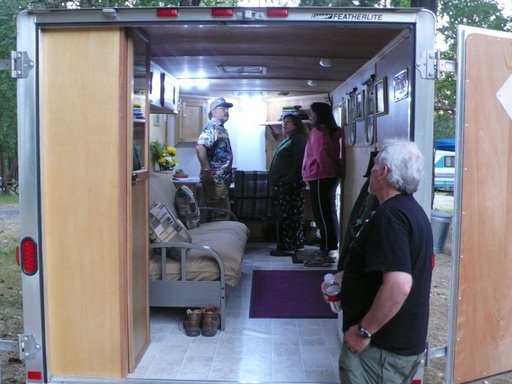

Postby mikeschn » Wed Aug 27, 2008 7:23 pm
Which one of these guys is you?
Nosecone

Which one?
Postby Prem » Wed Aug 27, 2008 7:41 pm
Mike,
I'm the guy in the back with Featherlite cap on being quizzed by the women about the LED lights on the ceiling.
I won that hat at a teardrop gathering during our Saturday evening bonfire about a year ago. The rest is history.

Postby Prem » Wed Aug 27, 2008 10:19 pm
Mike,
What *is* that you're drinking?
Yeah. t'was the LEDs what won the quiz. 0.66 amps from the little solar panels keep the battery topped off no matter how long I run the lights. Those gals couldn't believe how bright they are. (57 little LEDs per bulb/Perfect replacement for 1141 incandescent auto bulbs.)
