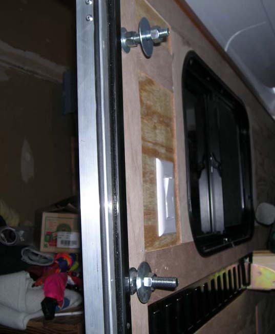

Postby digimark » Mon Jun 15, 2009 7:50 pm
UPDATE: I spent some time talking with a trailer tech at my dealer. He confirmed:
1. That you can't mount even a small AC unit into the back doors or the side door; there is no support for it in the door, and the weight of it will make the door sag. You could tear the door down and rebuild it with support, but that is so much work, it's probably not worth it.
2. If the AC unit is wider that the space between the 16" on-center studs, you'd need to cut a stud and then build a header box around it to support the weight of the AC unit and retain the wall/ceiling integrity. Unfortunately, the smallest unit I could find is 17 1/2" across. Which is OK, because (again) I really didn't want to cut a hole in the trailer.
3. He said hanging an inside door with the AC in it, or even a top-panel across the top of the door with hinges, won't work for the same reason putting it in the exterior doors won't work -- they'd sag.
BUT -- he suggested putting carriage bolts through the door frame where they won't interfere with the door... two on each side, and then bolting a 3/4" hardwood ply panel across the top of the door frame, securing it with wing nuts on the carriage bolts. I thought it was brilliant, because the carriage bolts are set-and-forget, and won't change the look, operation or capabilities of the trailer in any way. AND I can STILL remove the AC whenever I don't need it.
I'll still have to built a smaller door on hinges for under the AC unit. I'm thinking I can put foam tape around the AC on the panel to seal any gap between the panel and door frame. And I still have to build the AC support ledge into the panel. But needless to say, I'm thrilled by the solution. I'm going to drop the trailer by the dealer next Monday, he said it should take about an hour's work to install the carriage bolts properly.

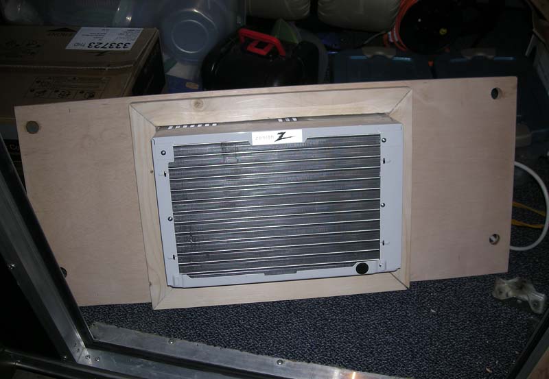

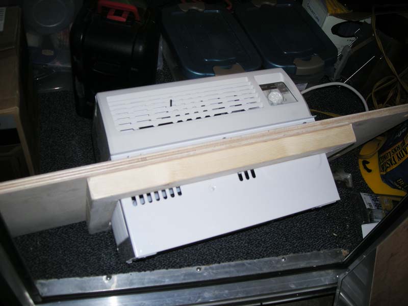

Postby digimark » Tue Jun 23, 2009 8:23 pm
OK -- progress!!
I've added some pictures to my album, but there are now four strong bolts installed on the trailer, two on each side of the side door. And the AC is mounted in the 3/4" plywood panel. I need to take a picture with the AC mounted, but the panel/AC covers about 1/3 of the side door opening, leaving a reasonable amount of space to climb in and out underneath the AC unit.
I have to stain/varnish the plywood and framing, and I still need to build a door underneath it to seal the rest of the opening when we are inside, but we have AC now!

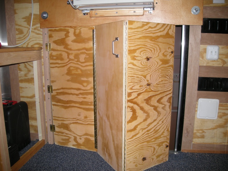

Postby digimark » Sat Jul 18, 2009 4:59 pm
Last piece is in place -- I built this three-piece filler panel from the leftover wood I had from making the bed platform. It's 1/2" hardwood ply -- each of the three pieces is 13" wide, and I used piano hinges to join the pieces and lift-off hinges to join the panel to the trailer wall. Oops -- except I put the hinges on upside down, so the pins pull out down to remove. Stained and secured to the left side of the door frame. I put a utility pull handle on each side of the door to make it easier to open/close, and I'm using Velcro to secure the door closed.
EDIT: I forgot to mention that I cut the length too long, and it drags on the carpet, so it's a bit difficult to open and close. Not sure how to fix that without removing the door again.
2ND EDIT: I took the door off, reversed the hinges, and cut an 1/8" off the bottom. So now it swings relatively freely. I'm using rubber strip insulation to fill any gaps.
Thanks for everyone's help. I've learned a lot.
