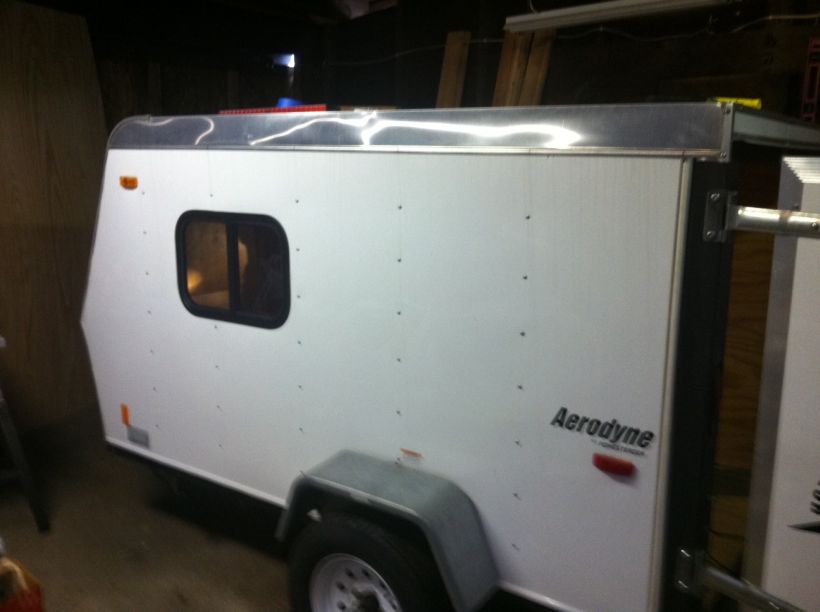

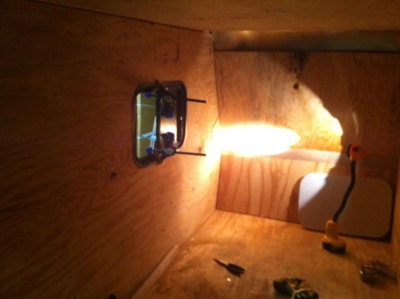

Nitroxjunkie71 wrote:meach4x4 wrote:Wow, excellent job!
Thanks Gilmeach4x4 wrote:I am going to change my approach to match what you did. I notice you used steel frame above and below the window cutout. Did you weld it in? Or, use screws?
I have the Z studs in my walls and the 1x1" O.D steel tubing fit just right. I did weld it in but brackets could be made to do the same thing. I removed the outer screws and shimmed the siding before I welded.meach4x4 wrote:Wells Cargo told me when they install them on their 5x8 trailers, they put the window cutout just below the top rail (about 4" above where yours are.) How high are your sides? Mine are only 5' 6".
The nice thing about doing it yourself is that you can put them anywhere you want to but I am sure they would as well if a move was requested. I just eyeballed it to find the location I liked. My dad had his put in on his new trailer and they are down from the top of the wall a bit but the trailer is a lot bigger than mine. My walls are 5' 3" from bottom to the start of radius and just over 5' on the inside.meach4x4 wrote:Do you have any finished shots? (Inside and out would be great!) Excellent shots, very motivating.
I have several shots of it but only a few during construction if that's what you are looking for. Those shots are all in my album.meach4x4 wrote:You've convinced me to wait until the windows are in to mount the bed, since I'd just have to take the rails off to do the windows and insulation. Backup... Rethink... Better than redo!
At least you figured that part out, I sure didn't. I have taken mine apart several times since the window install/insulation project. Once to wire in fender lights, once for the electrical, and once for the porch light with one more once to go Windows, Wiring (including porch light), insulation right down the line.
Have fun and please, Post Pictures!
