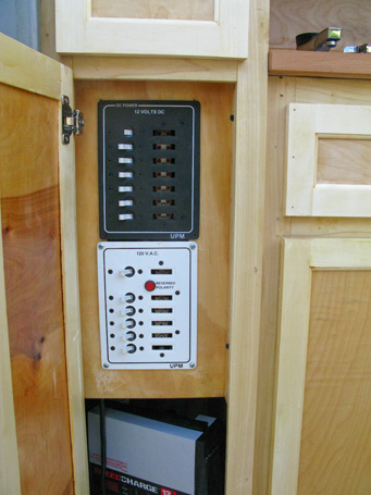

Postby dougbox » Sat Nov 07, 2009 11:39 pm
Thanks!
Here is a photo of the Electrical Panels, A/C and DC

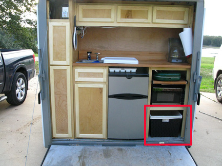

AC Placement
Postby dougbox » Tue Nov 10, 2009 9:16 pm
Gary, I did not insulate it. The trailer came with the 1/2 in chip board already installed. It just seemed too much trouble for 3/4 " of insulation. I plan on insulating the roof. I don't plan on camping in extreme temperatures.
My original idea was to put the A/C in the lower right hand corner (see red square). Then put a Fantastic Fan in the roof. I was going to put in the top of the line fan, anout $250, the A/C was going to run about $190. So I have decided now to put in a Roof mounted A/C with a hear strip. A bit more money but not much.

Postby Ageless » Tue Nov 10, 2009 9:18 pm
And with a bit of conduit; you could have a fold down frame for a patio cover in case of rain

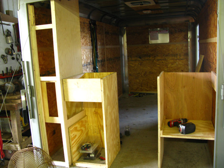

Postby dougbox » Tue Nov 10, 2009 9:30 pm
ImageGreat idea Raymond, I have a pop-up tent to put over the patio, but I did not need it this trip, nothing but sun.
Here is a build photo. You can see the permanent cabinet on the left. The smaller cabinet on the left is the sink cabinet. it comes out with the sink and counter top is attached to it. The small cabinet on the right is the stove and microwave cabinet and comes out.

Stile and Rail
Postby dougbox » Tue Nov 10, 2009 9:48 pm
I wanted to make the cabinets strong, attractive and light weight. I used the traditional Stile and Rail method of the cabinet doors. I used Aspen for the inet frames and the cabinet door frames. The panel is 1/4" birch plywood.
