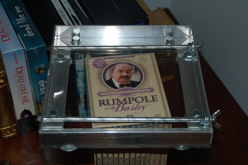

I found the forum posting I was thinking of that has an aluminum tray to secure a tank to. It's
http://www.tnttt.com/viewtopic.php?t=7931
Here's the picture from wlooper89's work:
Two pieces of angle iron or aluminum welded with the correct spacing to the tongue will do the same thing, I think. I need to find a local welder to help me.
