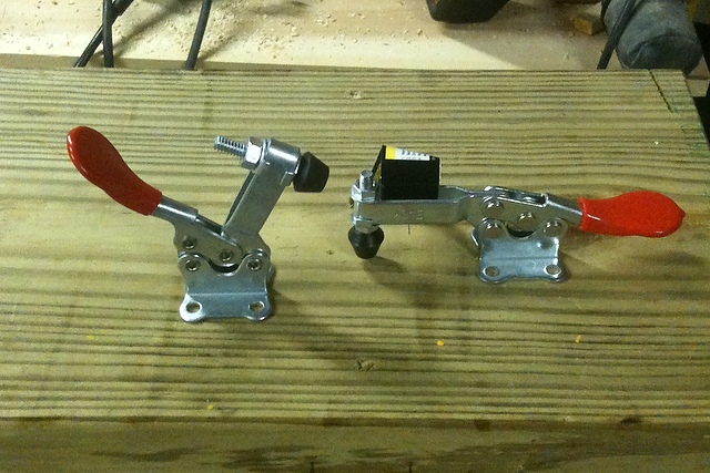

The "bed in back" had me confused for the longest time. Finally figured it out.
One could use these clamps
Image to compress the seal that Prem expressed concern over. They make them larger I just happened to have these that I picked up at Harbor Freight.
Now that I have the correct ends of the trailer worked out in my head, I will say that two barn doors will evenly split the trailer. Your design would require both of the doors to be open to enter/exit. Consider moving your galley all to one side next to the less opened (first closed) door. It could be a bit wider than the door for storage along the short "hallway" or your could incorporate the storage mounted against the outside wall in the "hallway". This would also lend itself to having a screen door like others have done with their conversions.
Earlier Prem had suggested to someone about a dual sided galley. Your design could be modified so that it could be accessed from inside (during inclement weather) or outside if you opened the second barn door. Perhaps using drawer slides or fold-down tables to extend work surfaces like I did in my conversion.
How are you going to support the bed when folded out into a bed? Are you going to have storage (or small benches) along each wall under the bed to support it when out?
