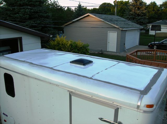

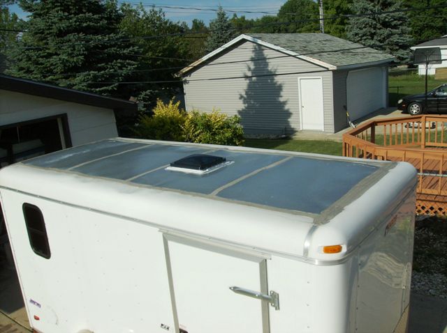

Postby Jeffmo63 » Tue Jul 13, 2010 8:26 pm
Here are a few pics of before and after. I really hope this helps the heat problem. Between this, insulation, and powered vent I think I will be ok. See album for additional pics.

Postby Jeffmo63 » Wed Jul 14, 2010 5:35 pm
I noticed an immediate improvement in the inside temperature due to painting the roof white. It was not much warmer than ambient and the sun was blazing today.

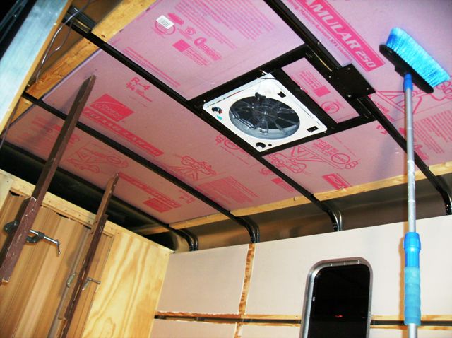

Insulation
Postby Jeffmo63 » Thu Jul 15, 2010 11:15 pm
Here is the overhead with the insulation installed. Note temporary bracing while thee adhesive cures.

Postby GPW » Fri Jul 16, 2010 5:45 am
J , sorry if I missed it , but what adhesive did you use to attach the foam ???
Postby GPW » Fri Jul 16, 2010 5:48 am
R value of the pink stuff ???
Postby Trackstriper » Fri Jul 16, 2010 6:51 am
GPW wrote:R value of the pink stuff ???
Looks like R4 in the photo above.

Postby Jeffmo63 » Fri Jul 16, 2010 2:32 pm
GPW wrote:J , sorry if I missed it , but what adhesive did you use to attach the foam ???
I used a product called PL300 Foamboard Adhesive. It is made by the Henkel Corporation out of mentor, OH. There is website: www.stickwithpl.com. I found it at Menards right next to the foamboard. It says it will not attack foam and I found this to be correct.

Postby Jeffmo63 » Fri Jul 16, 2010 2:39 pm
R-4. There has been a lot of chatter about the R value of the various insulations. A post that made sense to me suggested not to worry too much about the R value because the areas we are dealing with are so small. I think the general idea (at least in this case) is to reduce heat transmission to managable level. As I stated earlier (or in a different thread) between the white roof, insulation, crossflow ventilation, and thermostatically controlled fan I am hoping to get the heat problem under control.
