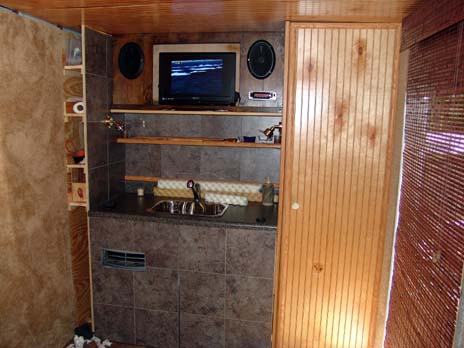

Galley in the back.
Postby rjw758 » Mon Aug 16, 2010 3:26 pm
I like what you did with the AC in back door. I'd like to do a conversion someday and after seeing yours I had the idea of making that area a little deeper and putting the galley there along with some type of awning.
What do you think?

Postby kstephenson » Mon Aug 16, 2010 5:06 pm
Good ideal....I thought about going deeper too for that reason.
